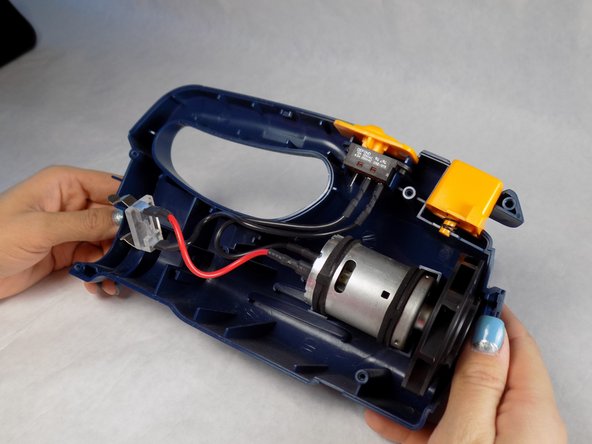

    • Using a Philips head screwdriver, remove the four screws located on the side panel of the vacuum.
    • There are two types of screws on this device. You may want to use a magnetic screw pad to organize your screws to be sure they return to their designated holes.
    • 4x 19.1mm
    • 1x 14.3mm
    • Once the screws are removed, you should be able to separate the side panel from the rest of the device.

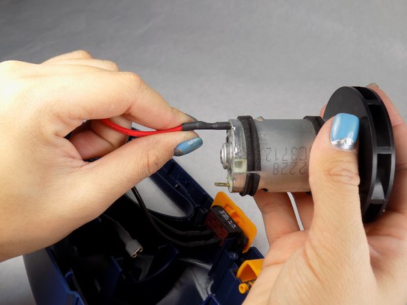

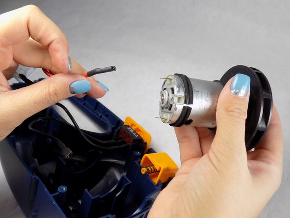

    • Pull your motor out, and remove the black and red cables from the motor by hand.
