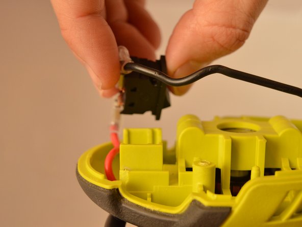

  5. Ryobi RS290G Power Switch Replacement, Power Switch: crwdns2935265:05crwdnd2935265:01crwdnd2935265:02crwdne2935265:0 Ryobi RS290G Power Switch Replacement, Power Switch: crwdns2935265:05crwdnd2935265:02crwdnd2935265:02crwdne2935265:0
    • Slide the power switch out of the housing assembly by carefully gripping the power switch and sliding upward from the base.

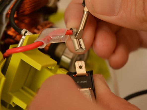

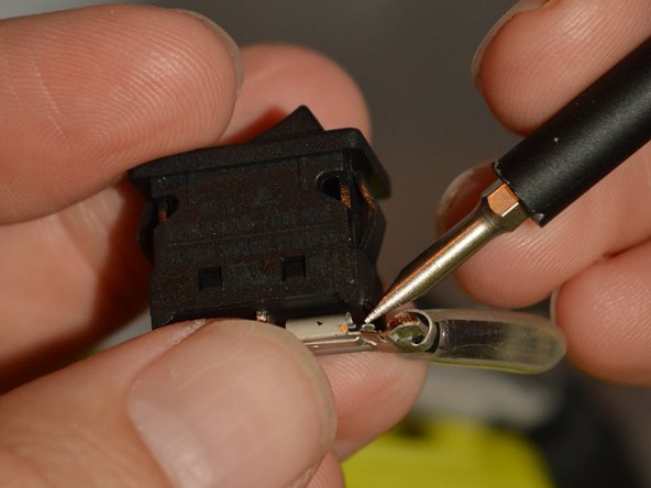

  6. Ryobi RS290G Power Switch Replacement: crwdns2935265:06crwdnd2935265:01crwdnd2935265:03crwdne2935265:0 Ryobi RS290G Power Switch Replacement: crwdns2935265:06crwdnd2935265:02crwdnd2935265:03crwdne2935265:0 Ryobi RS290G Power Switch Replacement: crwdns2935265:06crwdnd2935265:03crwdnd2935265:03crwdne2935265:0
    • Slide the red and black leads from the power switch using a spudger.
To reassemble your device, follow these instructions in reverse order. After reassembling, perform an operational check before using.
