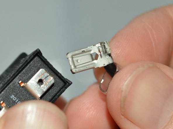

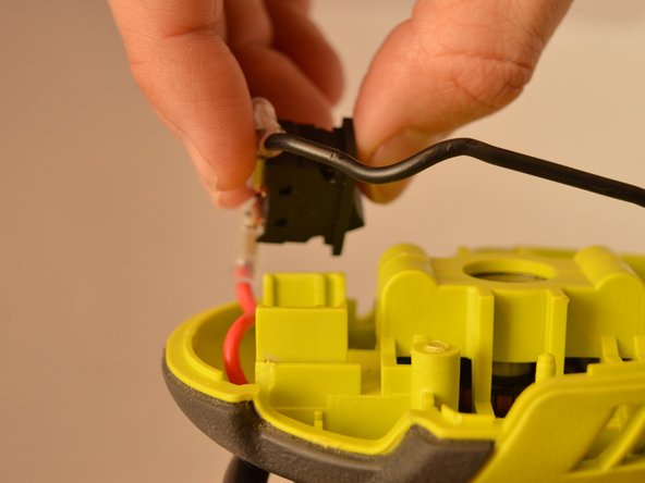

  8. Ryobi RS290G Power Cord Replacement: crwdns2935265:08crwdnd2935265:01crwdnd2935265:02crwdne2935265:0 Ryobi RS290G Power Cord Replacement: crwdns2935265:08crwdnd2935265:02crwdnd2935265:02crwdne2935265:0
    • Remove the black lead from the power switch using a spudger.

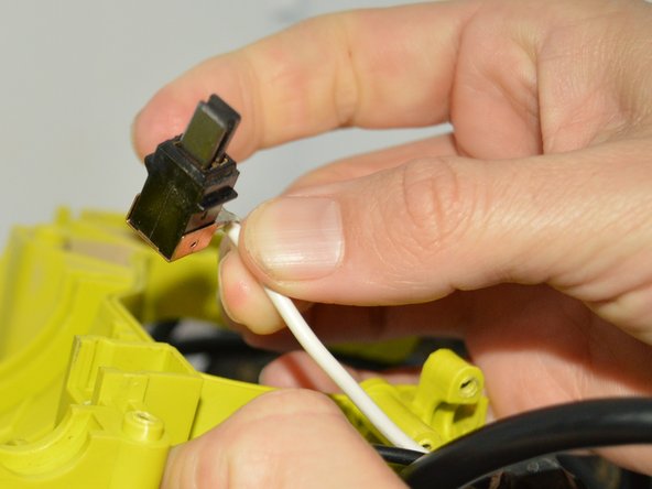

  10. Ryobi RS290G Power Cord Replacement: crwdns2935265:010crwdnd2935265:01crwdnd2935265:02crwdne2935265:0 Ryobi RS290G Power Cord Replacement: crwdns2935265:010crwdnd2935265:02crwdnd2935265:02crwdne2935265:0
    • Slide out the brush assembly with the white lead from the inner housing assembly.

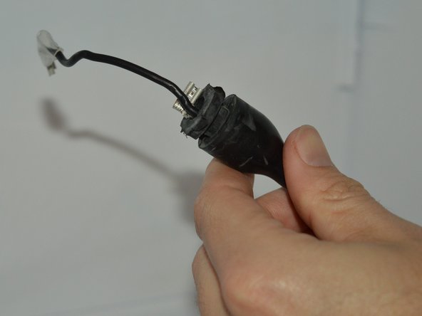

  12. Ryobi RS290G Power Cord Replacement: crwdns2935265:012crwdnd2935265:01crwdnd2935265:02crwdne2935265:0 Ryobi RS290G Power Cord Replacement: crwdns2935265:012crwdnd2935265:02crwdnd2935265:02crwdne2935265:0
    • Slide the bend relief off of the old power cord to reuse on the new power cord if there is no damage.
