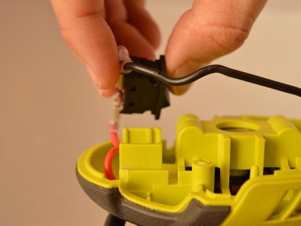

  5. Ryobi RS290G Brush Assembly Replacement, Brush Assembly: crwdns2935265:05crwdnd2935265:01crwdnd2935265:02crwdne2935265:0 Ryobi RS290G Brush Assembly Replacement, Brush Assembly: crwdns2935265:05crwdnd2935265:02crwdnd2935265:02crwdne2935265:0
    • Slide the power switch out of the housing assembly by carefully gripping the power switch and slide upward from the base.

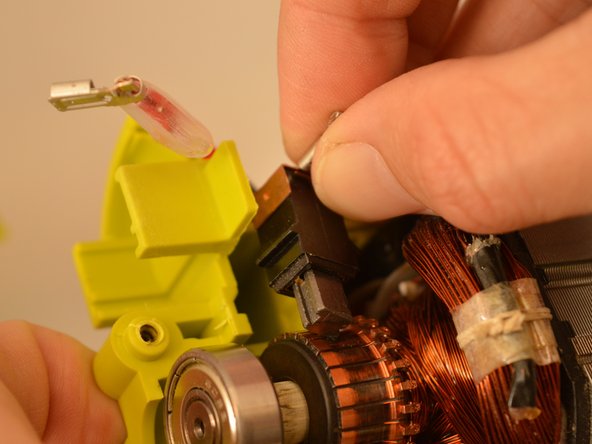

    • Slide out both brush assemblies from the inner housing assembly.
  10. Ryobi RS290G Brush Assembly Replacement: crwdns2935265:010crwdnd2935265:01crwdnd2935265:01crwdne2935265:0
    • Slide off the disconnect terminal for the brush assembly (white lead).
  11. Ryobi RS290G Brush Assembly Replacement: crwdns2935265:011crwdnd2935265:01crwdnd2935265:01crwdne2935265:0
    • Slide off the disconnect terminal for the brush assembly (black lead).
