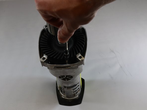

  11. Ryobi RJ1861V Motor Replacement, Motor: crwdns2935265:011crwdnd2935265:01crwdnd2935265:01crwdne2935265:0
    • The motor is divided into two sections, one attached to the gear case and one attached to the handle.
    • This arrow indicates the section attached to the gear case.
    • This arrow indicates the section attached to the handle.

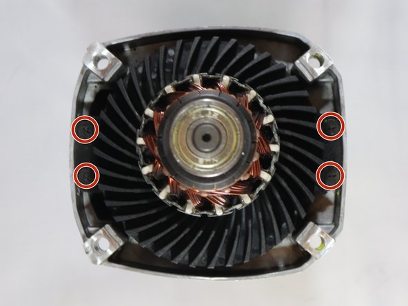

  12. Ryobi RJ1861V Motor Replacement: crwdns2935265:012crwdnd2935265:01crwdnd2935265:03crwdne2935265:0 Ryobi RJ1861V Motor Replacement: crwdns2935265:012crwdnd2935265:02crwdnd2935265:03crwdne2935265:0 Ryobi RJ1861V Motor Replacement: crwdns2935265:012crwdnd2935265:03crwdnd2935265:03crwdne2935265:0
    • Use a Torx T5 screwdriver to remove the four screws attaching the motor to the gear case.

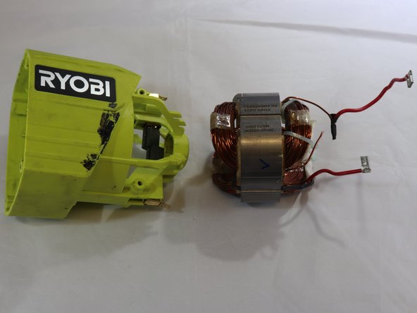

  14. Ryobi RJ1861V Motor Replacement: crwdns2935265:014crwdnd2935265:01crwdnd2935265:02crwdne2935265:0 Ryobi RJ1861V Motor Replacement: crwdns2935265:014crwdnd2935265:02crwdnd2935265:02crwdne2935265:0
    • Remove the four screws on the back of the housing with a Torx T5 screwdriver.
    • Flip the housing over and pull the motor up and out of the housing.
