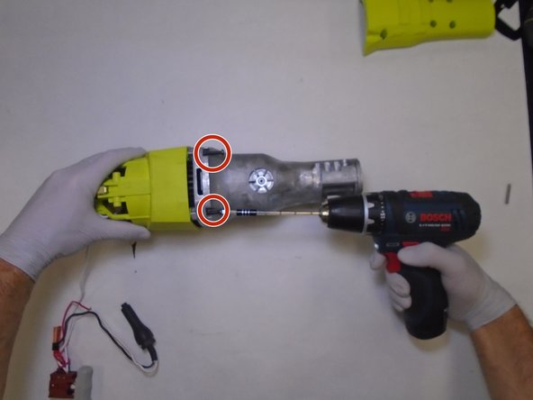

    • Use a Torx T20 bit or screwdriver to remove the six 19 mm screws securing the gear case cover.
  4. Ryobi RJ1861V Motor Housing Replacement: crwdns2935265:04crwdnd2935265:01crwdnd2935265:02crwdne2935265:0 Ryobi RJ1861V Motor Housing Replacement: crwdns2935265:04crwdnd2935265:02crwdnd2935265:02crwdne2935265:0
    • Use a Phillips #2 bit or screwdriver to remove the four 37 mm screws from the top and the bottom of the gear case.
    • Once these 4 screws are removed, you have access to the motor assembly.
