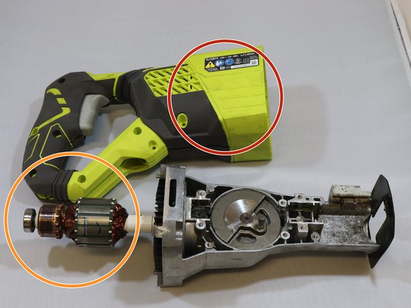

  11. Ryobi RJ1861V Motor Housing Replacement, Motor Housing: crwdns2935265:011crwdnd2935265:01crwdnd2935265:02crwdne2935265:0 Ryobi RJ1861V Motor Housing Replacement, Motor Housing: crwdns2935265:011crwdnd2935265:02crwdnd2935265:02crwdne2935265:0
    • After following prerequisite guides to get to the presented step, remove motor assembly from back housing.
    • Motor Assembly will be greasy
    • Motor Assembly
    • Motor Assembly Housing
  12. Ryobi RJ1861V Motor Housing Replacement: crwdns2935265:012crwdnd2935265:01crwdnd2935265:01crwdne2935265:0
    • Using pliers to grab onto the elongated aluminium exterior of the housing, begin to slowly wiggle the motor assembly housing until it comes loose.
  13. Ryobi RJ1861V Motor Housing Replacement: crwdns2935265:013crwdnd2935265:01crwdnd2935265:01crwdne2935265:0
    • Detach red wires from base of the back of the housing .
  14. Ryobi RJ1861V Motor Housing Replacement: crwdns2935265:014crwdnd2935265:01crwdnd2935265:01crwdne2935265:0
    • After the wires have been detached it should be relatively easy to remove and replace the Motor Assembly Housing
