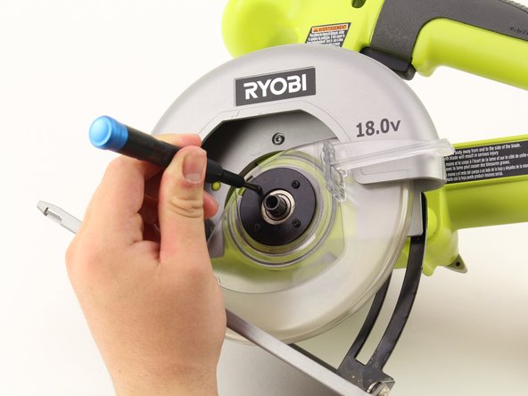

    • Locate the area where the blade is connected to the motor, where the circular covering is on the Ryobi P501G.
  2. Ryobi P501G Shell Replacement: crwdns2935265:02crwdnd2935265:01crwdnd2935265:02crwdne2935265:0 Ryobi P501G Shell Replacement: crwdns2935265:02crwdnd2935265:02crwdnd2935265:02crwdne2935265:0
    • Unscrew clockwise and remove the bearing in the middle, connecting the blade to the motor. This will also allow removal of the blade guard.
  3. Ryobi P501G Shell Replacement: crwdns2935265:03crwdnd2935265:01crwdnd2935265:03crwdne2935265:0 Ryobi P501G Shell Replacement: crwdns2935265:03crwdnd2935265:02crwdnd2935265:03crwdne2935265:0 Ryobi P501G Shell Replacement: crwdns2935265:03crwdnd2935265:03crwdnd2935265:03crwdne2935265:0
    • Remove the four black screws holding the black bearing and remove the bearing itself.
  4. Ryobi P501G Shell Replacement: crwdns2935265:04crwdnd2935265:01crwdnd2935265:01crwdne2935265:0
    • Once the black bearing is off, remove the transparent cover of the blade.
    • Once the cover is off, remove the blade.
    • Place the new blade with the flat notches lined up with the flat notches on the motor axle.
