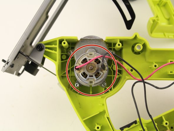

  3. Ryobi P501G Motor Replacement: crwdns2935265:03crwdnd2935265:01crwdnd2935265:02crwdne2935265:0 Ryobi P501G Motor Replacement: crwdns2935265:03crwdnd2935265:02crwdnd2935265:02crwdne2935265:0
    • Open up the top side of the encasement to reveal the internal parts of the saw.
    • Locate the motor.

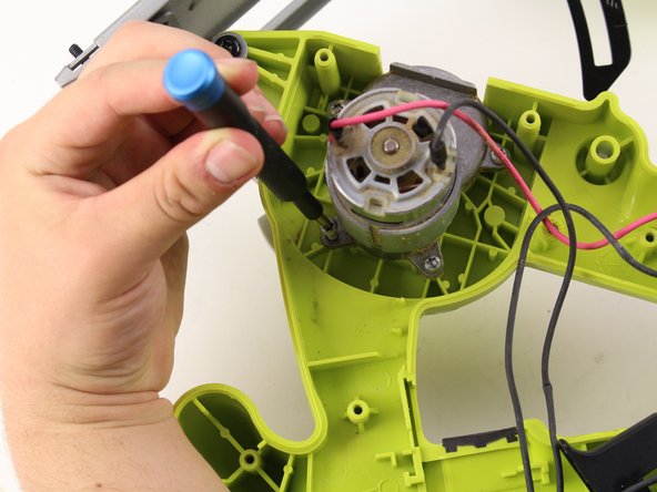

  4. Ryobi P501G Motor Replacement: crwdns2935265:04crwdnd2935265:01crwdnd2935265:02crwdne2935265:0 Ryobi P501G Motor Replacement: crwdns2935265:04crwdnd2935265:02crwdnd2935265:02crwdne2935265:0
    • Using the T15 torx screwdriver, unscrew all four of the screws to free the motor from the encasement.
  5. Ryobi P501G Motor Replacement: crwdns2935265:05crwdnd2935265:01crwdnd2935265:01crwdne2935265:0
    • Remove the motor and replace with a new one if needed.
    • Be careful when handling the motor- it may be very dirty/greasy. You might want to wear gloves for this step!
