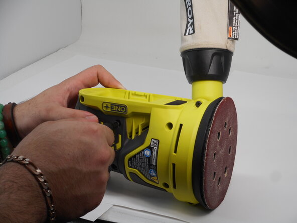

  3. Ryobi P411 Casing Replacement, Casing: crwdns2935265:03crwdnd2935265:01crwdnd2935265:02crwdne2935265:0 Ryobi P411 Casing Replacement, Casing: crwdns2935265:03crwdnd2935265:02crwdnd2935265:02crwdne2935265:0
    • Use a Phillips #1 screwdriver to remove the eight M4 x 18.5mm screws from the side of the casing.

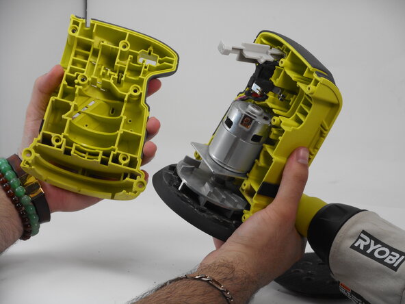

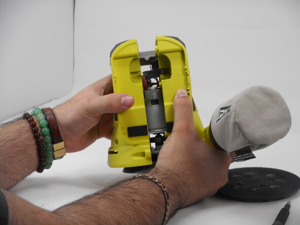

  4. Ryobi P411 Casing Replacement: crwdns2935265:04crwdnd2935265:01crwdnd2935265:03crwdne2935265:0 Ryobi P411 Casing Replacement: crwdns2935265:04crwdnd2935265:02crwdnd2935265:03crwdne2935265:0 Ryobi P411 Casing Replacement: crwdns2935265:04crwdnd2935265:03crwdnd2935265:03crwdne2935265:0
    • Open the sander by separating each half of the case apart.
