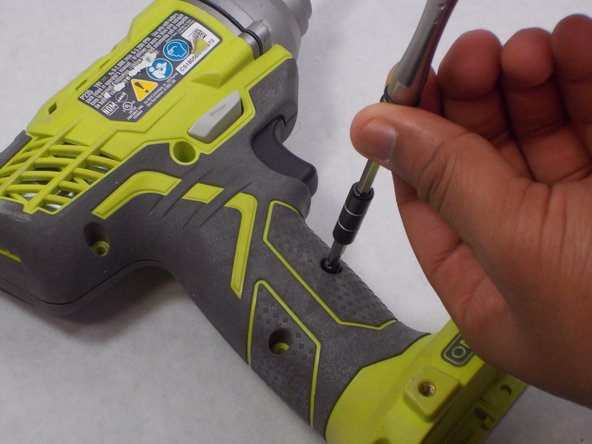

    1. Ryobi P235 Motor Replacement, Motor: crwdns2935265:03crwdnd2935265:01crwdnd2935265:02crwdne2935265:0 Ryobi P235 Motor Replacement, Motor: crwdns2935265:03crwdnd2935265:02crwdnd2935265:02crwdne2935265:0
      • Use a Phillips #2 screwdriver to remove the eight 16 mm screws that secure the housing.

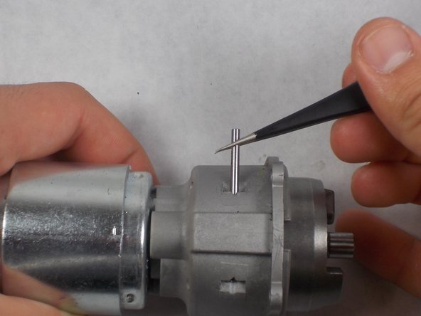

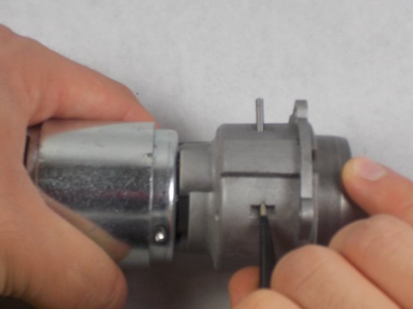

    7. Ryobi P235 Motor Replacement: crwdns2935265:09crwdnd2935265:01crwdnd2935265:03crwdne2935265:0 Ryobi P235 Motor Replacement: crwdns2935265:09crwdnd2935265:02crwdnd2935265:03crwdne2935265:0 Ryobi P235 Motor Replacement: crwdns2935265:09crwdnd2935265:03crwdnd2935265:03crwdne2935265:0
      • Remove the metal pins on each side of the inner case assembly.
      • It is easiest to push the pin through the opening from one side and once enough of the pin is through, grab it with the tweezers and pull it the rest of the way through.
      • When reassembling, make sure the pin goes in straight and makes it out the other side, rather than going in diagonally and into the inner case assembly.

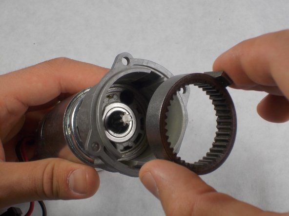

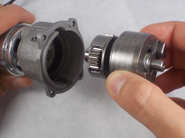

    8. Ryobi P235 Motor Replacement: crwdns2935265:010crwdnd2935265:01crwdnd2935265:02crwdne2935265:0 Ryobi P235 Motor Replacement: crwdns2935265:010crwdnd2935265:02crwdnd2935265:02crwdne2935265:0
      • Remove the ring gear.
      • To help lift the ring gear out of the inner case assembly, wedge the spudger under one side, moving it up by a little, then switch to the other side and repeat until the gear ring is out.

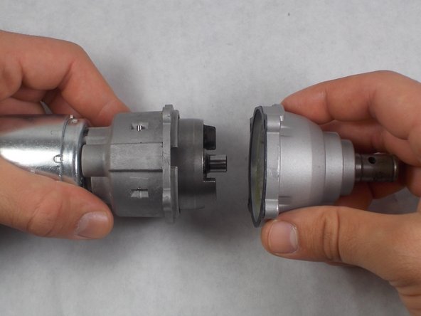

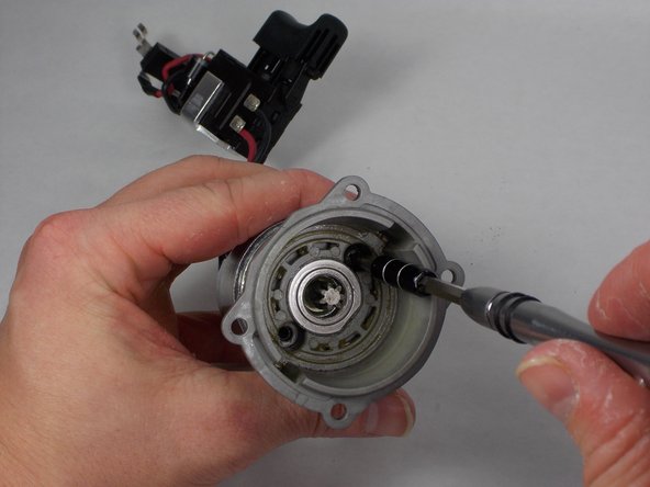

    9. Ryobi P235 Motor Replacement: crwdns2935265:011crwdnd2935265:01crwdnd2935265:03crwdne2935265:0 Ryobi P235 Motor Replacement: crwdns2935265:011crwdnd2935265:02crwdnd2935265:03crwdne2935265:0 Ryobi P235 Motor Replacement: crwdns2935265:011crwdnd2935265:03crwdnd2935265:03crwdne2935265:0
      • Remove the two 8mm screws and spring washers connecting the motor to the inner case assembly.
      • Separate the two parts.

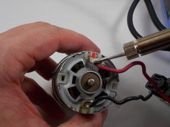

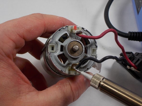

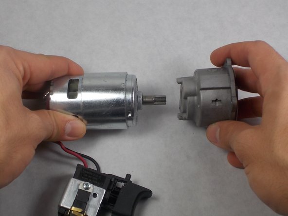

    10. Ryobi P235 Motor Replacement: crwdns2935265:012crwdnd2935265:01crwdnd2935265:03crwdne2935265:0 Ryobi P235 Motor Replacement: crwdns2935265:012crwdnd2935265:02crwdnd2935265:03crwdne2935265:0 Ryobi P235 Motor Replacement: crwdns2935265:012crwdnd2935265:03crwdnd2935265:03crwdne2935265:0
      • Use a soldering iron to remove the black and red wires connecting the motor to the trigger assembly.
      • Use the soldering iron to connect the new motor to the trigger assembly.
      • Make sure the red wire connects to the lead with the red mark on it.
