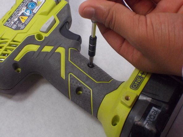

      • Use a Phillips #2 screwdriver to remove the eight 16 mm screws that secure the housing.

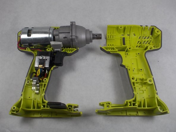

      • Open the housing with the data label facing up.
    4. Ryobi P235 Direction of Rotation Selector Replacement: crwdns2935265:06crwdnd2935265:01crwdnd2935265:02crwdne2935265:0 Ryobi P235 Direction of Rotation Selector Replacement: crwdns2935265:06crwdnd2935265:02crwdnd2935265:02crwdne2935265:0

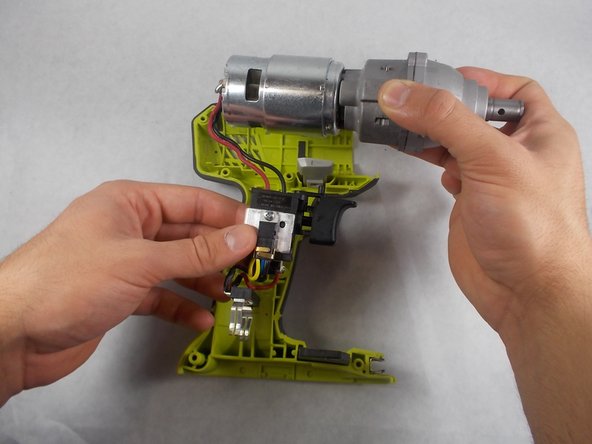

      • Lift the internal components out of the housing.
    5. Ryobi P235 Direction of Rotation Selector Replacement: crwdns2935265:07crwdnd2935265:01crwdnd2935265:02crwdne2935265:0 Ryobi P235 Direction of Rotation Selector Replacement: crwdns2935265:07crwdnd2935265:02crwdnd2935265:02crwdne2935265:0

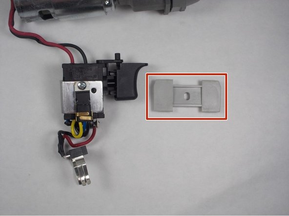

      • Remove the gray plastic forward/reverse selector.
