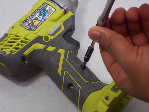

    1. Ryobi P235 Bit-Holder Replacement, Bit-Holder: crwdns2935265:03crwdnd2935265:01crwdnd2935265:02crwdne2935265:0 Ryobi P235 Bit-Holder Replacement, Bit-Holder: crwdns2935265:03crwdnd2935265:02crwdnd2935265:02crwdne2935265:0
      • Use a Phillips #2 screwdriver to remove the eight 16 mm screws that secure the housing.
    2. Ryobi P235 Bit-Holder Replacement: crwdns2935265:04crwdnd2935265:01crwdnd2935265:02crwdne2935265:0 Ryobi P235 Bit-Holder Replacement: crwdns2935265:04crwdnd2935265:02crwdnd2935265:02crwdne2935265:0
      • Use a T20 Torx screwdriver to remove the four 25.4 mm screws that secure the front of the housing.

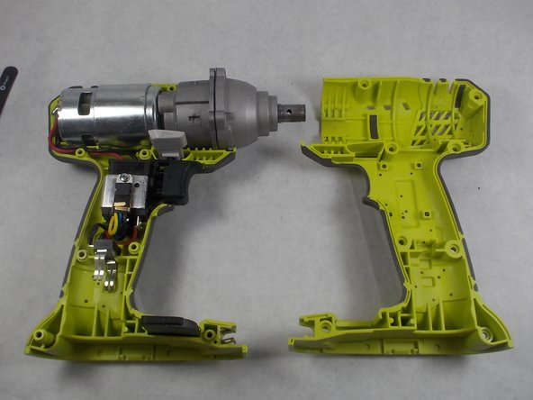

      • Open the housing with the data label facing up.
    4. Ryobi P235 Bit-Holder Replacement: crwdns2935265:06crwdnd2935265:01crwdnd2935265:02crwdne2935265:0 Ryobi P235 Bit-Holder Replacement: crwdns2935265:06crwdnd2935265:02crwdnd2935265:02crwdne2935265:0

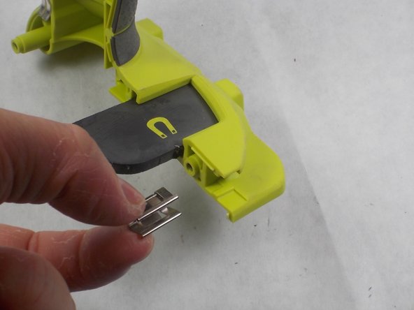

      • Remove the old bit holder.
