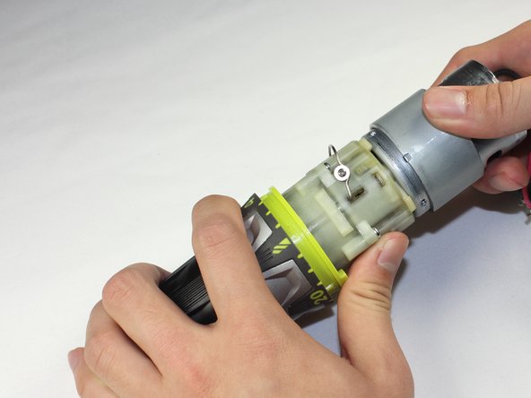

    1. Ryobi P202 Motor Replacement, Motor: crwdns2935265:011crwdnd2935265:01crwdnd2935265:02crwdne2935265:0 Ryobi P202 Motor Replacement, Motor: crwdns2935265:011crwdnd2935265:02crwdnd2935265:02crwdne2935265:0
      • Gripping the rear of the motor and the chuck, lift up.
      • There are two copper springs that are attached to the front of the chuck. They may fall off when lifting the chuck, so be careful when doing so.
    2. Ryobi P202 Motor Replacement: crwdns2935265:012crwdnd2935265:01crwdnd2935265:02crwdne2935265:0 Ryobi P202 Motor Replacement: crwdns2935265:012crwdnd2935265:02crwdnd2935265:02crwdne2935265:0
      • Remove the copper springs. There are two on the either sides of the chuck and are loosely placed in the chuck's grooves.
      • These springs are small and may fall off when you lift the motor up. Take note of the springs when doing so.

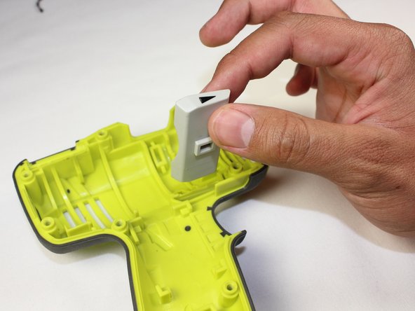

    3. Ryobi P202 Motor Replacement: crwdns2935265:013crwdnd2935265:01crwdnd2935265:02crwdne2935265:0 Ryobi P202 Motor Replacement: crwdns2935265:013crwdnd2935265:02crwdnd2935265:02crwdne2935265:0
      • Lift up on the direction toggle to remove it from the case.

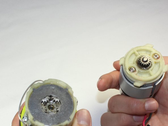

    4. Ryobi P202 Motor Replacement: crwdns2935265:014crwdnd2935265:01crwdnd2935265:03crwdne2935265:0 Ryobi P202 Motor Replacement: crwdns2935265:014crwdnd2935265:02crwdnd2935265:03crwdne2935265:0 Ryobi P202 Motor Replacement: crwdns2935265:014crwdnd2935265:03crwdnd2935265:03crwdne2935265:0
      • Hold the chuck and twist the motor clockwise and then pull apart to separate the motor from the chuck.
      • The chuck has a loose black washer that holds five gears in place. Be careful not to separate the washer.
      • When reassembling the chuck and motor, take note that the red wire in the back of the motor is farthest from the top of the assembly. In other words, the red wire should be closest to the trigger.

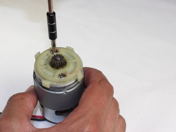

    5. Ryobi P202 Motor Replacement: crwdns2935265:015crwdnd2935265:01crwdnd2935265:02crwdne2935265:0 Ryobi P202 Motor Replacement: crwdns2935265:015crwdnd2935265:02crwdnd2935265:02crwdne2935265:0
      • Unscrew the two 10mm Philips #1 screws to remove the plastic spacer. Be careful not to lose the metal ring washers that come with the screws.

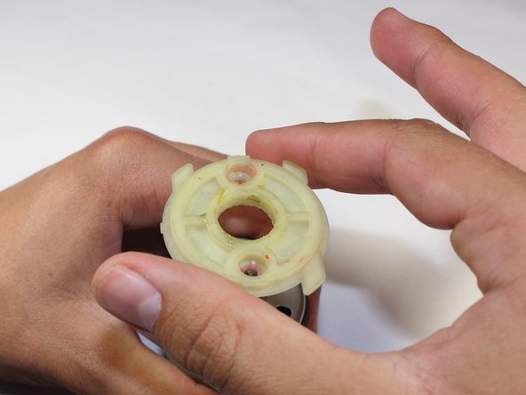

    6. Ryobi P202 Motor Replacement: crwdns2935265:016crwdnd2935265:01crwdnd2935265:03crwdne2935265:0 Ryobi P202 Motor Replacement: crwdns2935265:016crwdnd2935265:02crwdnd2935265:03crwdne2935265:0 Ryobi P202 Motor Replacement: crwdns2935265:016crwdnd2935265:03crwdnd2935265:03crwdne2935265:0
      • Remove the plastic spacer by lifting it straight up.
