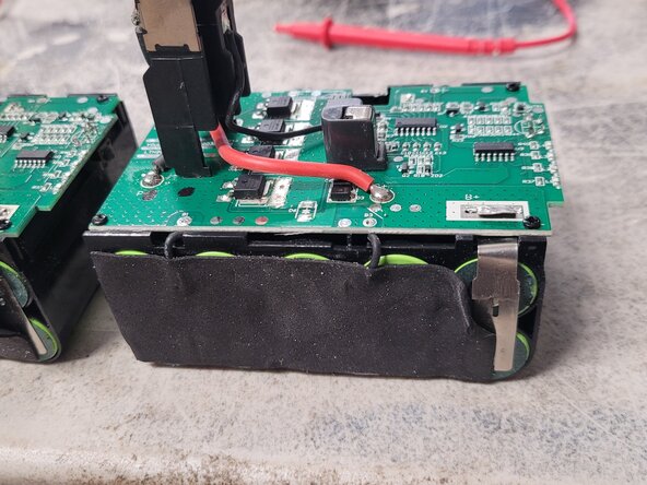

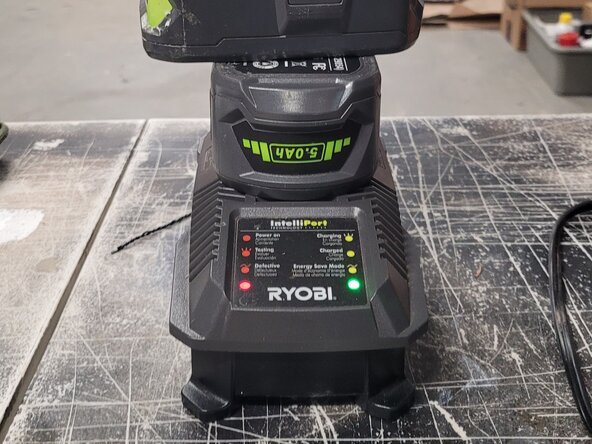

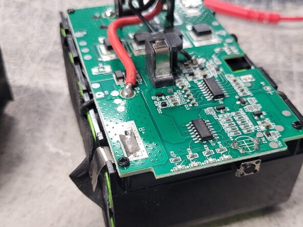

    • The common failure of these batteries is that they drop below the voltage required for the battery charger to recognise that there is a battery connected to the charger. However, I have had two batteries that still would not charge, so I removed the case and had a look. This guide shows what I found and how to repair.
  2. Ryobi One plus 18V Li-ion Battery (130501002) Technique: crwdns2935265:02crwdnd2935265:01crwdnd2935265:03crwdne2935265:0 Ryobi One plus 18V Li-ion Battery (130501002) Technique: crwdns2935265:02crwdnd2935265:02crwdnd2935265:03crwdne2935265:0 Ryobi One plus 18V Li-ion Battery (130501002) Technique: crwdns2935265:02crwdnd2935265:03crwdnd2935265:03crwdne2935265:0

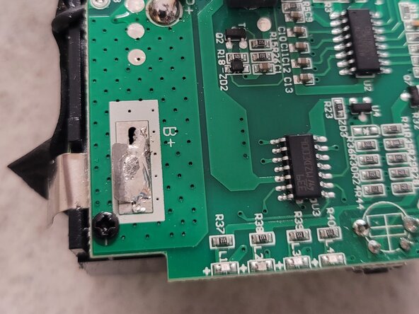

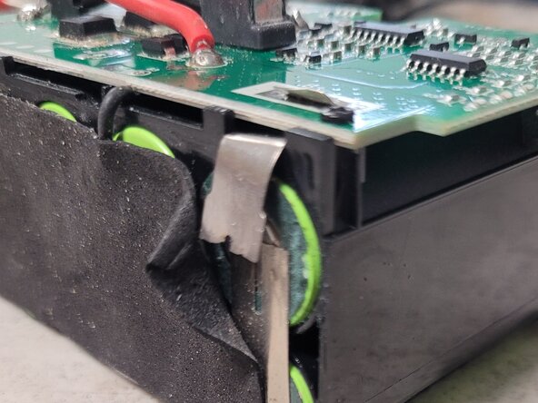

    • Once the case is removed, peel back the rubber insulation from the battery cell cover directly under the B+ connection on the circuit board
