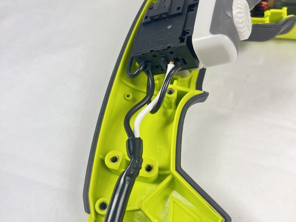

  3. Ryobi D620H Trigger Replacement, Power Cord: crwdns2935265:03crwdnd2935265:01crwdnd2935265:01crwdne2935265:0
    • The bend relief cover at the bottom of the handle.
    • Follow the wires coming out of the bend relief cover to the white power cord clamp with the two 14 mm black PH1 screws.
  4. Ryobi D620H Trigger Replacement: crwdns2935265:04crwdnd2935265:01crwdnd2935265:02crwdne2935265:0 Ryobi D620H Trigger Replacement: crwdns2935265:04crwdnd2935265:02crwdnd2935265:02crwdne2935265:0
    • Unscrew the two 14 mm PH1 screws holding the power cord wire in place.
    • Lift the switch box from its place gently.

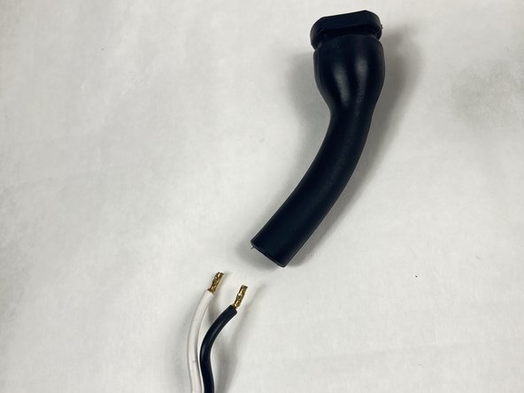

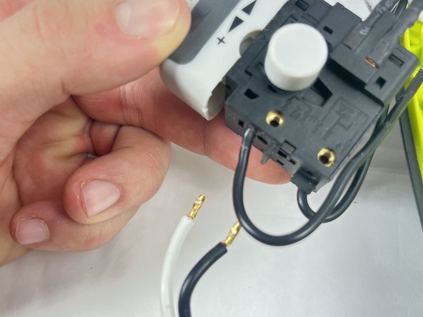

  5. Ryobi D620H Trigger Replacement: crwdns2935265:05crwdnd2935265:01crwdnd2935265:03crwdne2935265:0 Ryobi D620H Trigger Replacement: crwdns2935265:05crwdnd2935265:02crwdnd2935265:03crwdne2935265:0 Ryobi D620H Trigger Replacement: crwdns2935265:05crwdnd2935265:03crwdnd2935265:03crwdne2935265:0
    • Remove the two little screws holding the brass terminal lugs in place. Although it is not required, you can remove the screws completely if you find that doing so is more convenient.
    • Gently pull the white positive and black negative wires that are connected to the switch box.
    • Slide the bend relief guard off the cord towards the loose connections.
  6. Ryobi D620H Trigger Replacement, Trigger: crwdns2935265:06crwdnd2935265:01crwdnd2935265:02crwdne2935265:0 Ryobi D620H Trigger Replacement, Trigger: crwdns2935265:06crwdnd2935265:02crwdnd2935265:02crwdne2935265:0
    • Pull the four cables from the trigger terminals.
  7. Ryobi D620H Trigger Replacement: crwdns2935265:07crwdnd2935265:01crwdnd2935265:01crwdne2935265:0
    • Pull the two black wires that connect the motor from the switch box.
    • This may require some force.
    • When replacing the switch box these connections push into the new switch box.
