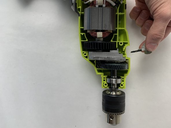

    • Turn the drill so that the screws face upwards.
    • Use the Torx T20 screwdriver to remove all nine screws.
  2. Ryobi D620H Mode Selector Switch Replacement: crwdns2935265:02crwdnd2935265:01crwdnd2935265:02crwdne2935265:0 Ryobi D620H Mode Selector Switch Replacement: crwdns2935265:02crwdnd2935265:02crwdnd2935265:02crwdne2935265:0
    • Insert the end of an opening tool between the right and left sides of the drill to pry the right side of the case.
    • Remove the right side case to expose the inside of the drill.

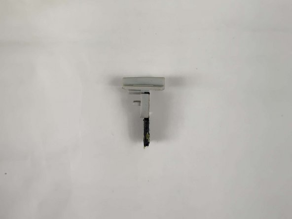

  3. Ryobi D620H Mode Selector Switch Replacement, Mode Selector Switch: crwdns2935265:03crwdnd2935265:01crwdnd2935265:01crwdne2935265:0
    • The mode selector switch (Circled in red) once the right side case is removed.
    • Before disassembling, the mode shift button is visible on the top of the case.
  4. Ryobi D620H Mode Selector Switch Replacement: crwdns2935265:04crwdnd2935265:01crwdnd2935265:03crwdne2935265:0 Ryobi D620H Mode Selector Switch Replacement: crwdns2935265:04crwdnd2935265:02crwdnd2935265:03crwdne2935265:0 Ryobi D620H Mode Selector Switch Replacement: crwdns2935265:04crwdnd2935265:03crwdnd2935265:03crwdne2935265:0
    • Push the mode selector switch up (away from the work surface) to dislodge it.
    • Lift the mode selector switch out of its slot.
To reassemble your device, place the mode shift button in the slot it was removed from at a slight angle and straighten it out as you push it into place.
Congratulations, you have replaced the mode shift button on your Ryobi hammer drill!
