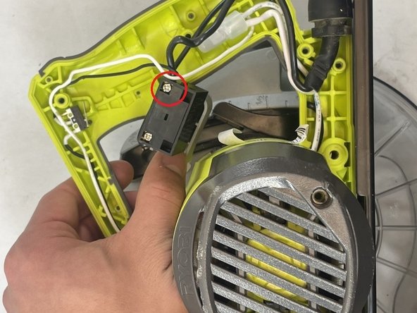

    • After removing the handle assembly locate the trigger switch and wire nut in the saw.
    • Remove the screw from the black wire of the power cord using a Phillips screwdriver. Then remove the wire.
    • Loosen the wire nut and remove the neutral wire from the power cord.
  4. Ryobi CSB135L Power Cord Replacement: crwdns2935265:04crwdnd2935265:01crwdnd2935265:01crwdne2935265:0
    • Remove the power cord from the saw.
    • To insert the replacement power cord, insert the black wire of the cord into the trigger switch and tighten the screw. Take the neutral/white wire of the new cord and insert it into the wire nut and tighten the nut.
    • Wire strippers may be needed when installing the new power cord to expose the copper wire.
