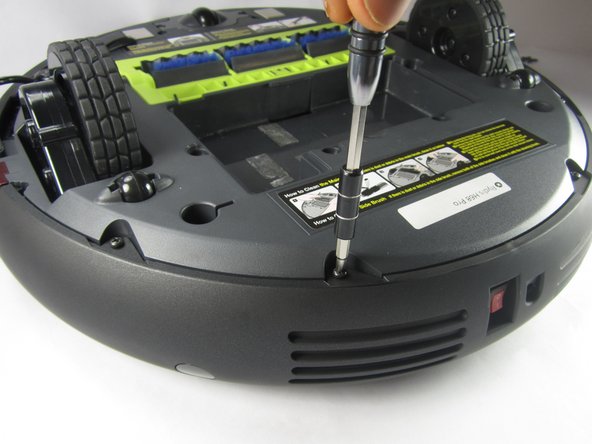

    • Flip the vacuum over so that the wheels are facing you.
    • Use a Phillips #1 screwdriver to remove the four 10 mm screws that surround the battery cover.

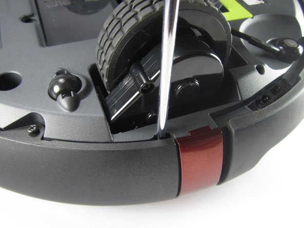

    • Remove the eight 10 mm Phillips #1 screws.

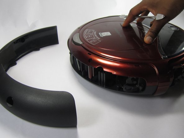

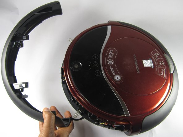

    • Hold the front bumper and pull it off.
    • It requires a lot of force to pull the bumper off.

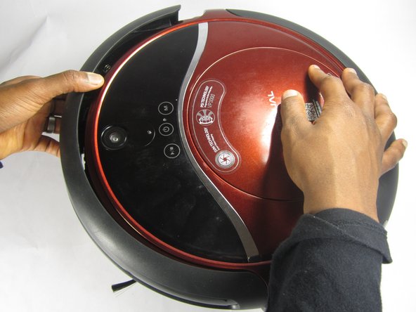

    • Pry off the back bumper by going around the entire top of the bumper with the metal spudger.
