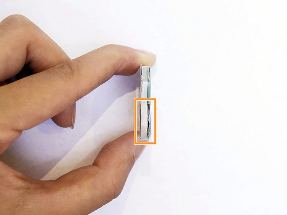

    • Begin by placing the watch on its backside.
  2. Rubber Watch Battery Replacement: crwdns2935265:02crwdnd2935265:01crwdnd2935265:03crwdne2935265:0 Rubber Watch Battery Replacement: crwdns2935265:02crwdnd2935265:02crwdnd2935265:03crwdne2935265:0 Rubber Watch Battery Replacement: crwdns2935265:02crwdnd2935265:03crwdnd2935265:03crwdne2935265:0
    • Gently pull the top of the watch's back until the cap detaches, in a peeling motion.
    • Pull out the white cap and green chip once it is free.

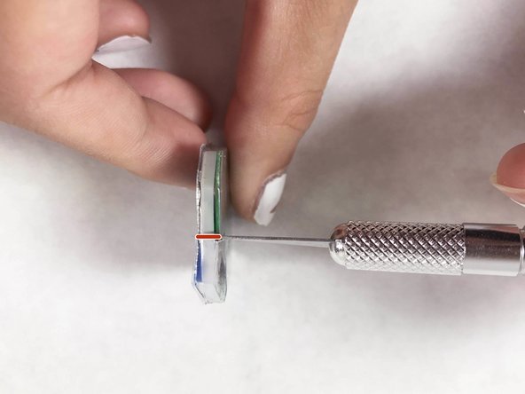

  3. Rubber Watch Battery Replacement: crwdns2935265:03crwdnd2935265:01crwdnd2935265:01crwdne2935265:0
    • Carefully puncture the plastic casing next to the battery on top of the green chip with the X-Acto knife and stop.
    • Be careful not to insert the X-Acto knife too downward into the battery.
  4. Rubber Watch Battery Replacement: crwdns2935265:04crwdnd2935265:01crwdnd2935265:03crwdne2935265:0 Rubber Watch Battery Replacement: crwdns2935265:04crwdnd2935265:02crwdnd2935265:03crwdne2935265:0 Rubber Watch Battery Replacement: crwdns2935265:04crwdnd2935265:03crwdnd2935265:03crwdne2935265:0
    • Flip the chip around to the front.
    • In a chiseling motion, make an incision on the front side above the battery to cut out a plastic casing.
    • Make sure to hold the knife away from the hands in a safe, stable grip.
    • Remove the cut plastic casing over the battery.
    • The plastic casing should come off like a cap.

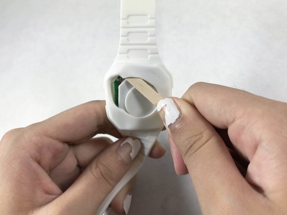

  5. Rubber Watch Battery Replacement: crwdns2935265:05crwdnd2935265:01crwdnd2935265:01crwdne2935265:0
    • Gently remove the battery with a spudger or a wooden coffee stick.
    • Using too much force may detach the tab holding the battery and break the watch.
    • Once free, remove the dead battery.

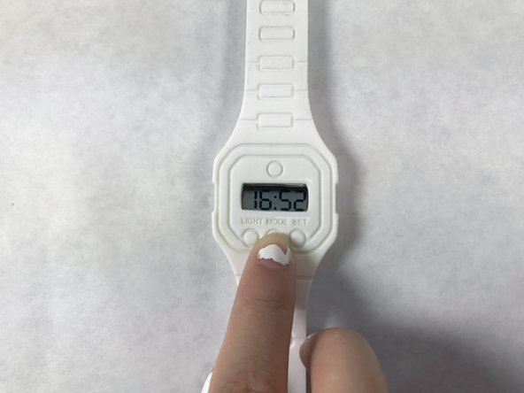

  6. Rubber Watch Battery Replacement: crwdns2935265:06crwdnd2935265:01crwdnd2935265:01crwdne2935265:0
    • Insert the new battery.
    • Place the cut plastic cap casing over the chip and battery.
  7. Rubber Watch Battery Replacement: crwdns2935265:07crwdnd2935265:01crwdnd2935265:03crwdne2935265:0 Rubber Watch Battery Replacement: crwdns2935265:07crwdnd2935265:02crwdnd2935265:03crwdne2935265:0 Rubber Watch Battery Replacement: crwdns2935265:07crwdnd2935265:03crwdnd2935265:03crwdne2935265:0
    • Place the white cap over the green chip.
    • Insert the white cap and green chip into the back of the watch with the spudger or wooden coffee stick.
    • Turn over the watch and check the power.
