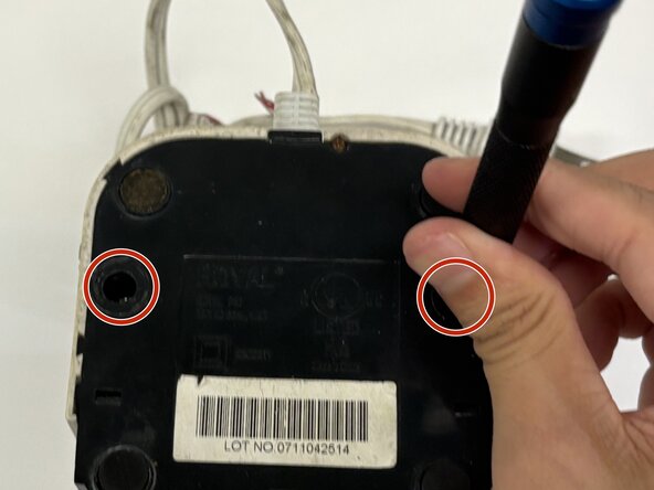

    • Turn your pencil sharpener over so the bottom is facing up.
    • Use a spudger to remove the rubber screw covers.
    • Use a Phillips #1 screwdriver to remove the screws from the bottom of the device.

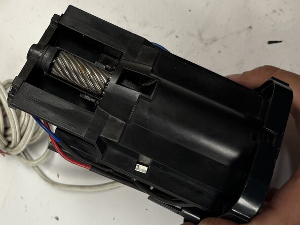

    • Take off the white cover by sliding it up along the mechanism. This should reveal both the blade mechanism as well as some wiring in the back.

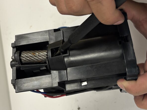

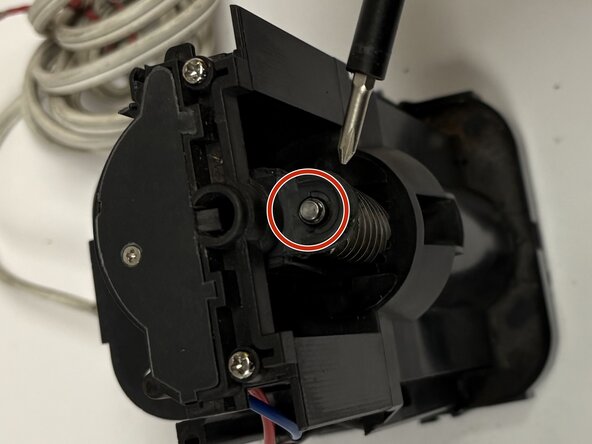

    • Using your hands and a little bit of force, pry off the black disk-like component that can be seen highlighted here.
  4. Royal P50 Electric Pencil Sharpener Blades Replacement: crwdns2935265:04crwdnd2935265:01crwdnd2935265:02crwdne2935265:0 Royal P50 Electric Pencil Sharpener Blades Replacement: crwdns2935265:04crwdnd2935265:02crwdnd2935265:02crwdne2935265:0

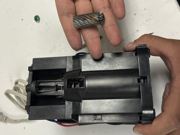

    • Take note of the metal rod that is now exposed and directly connected to the blade; this is what we want to remove.

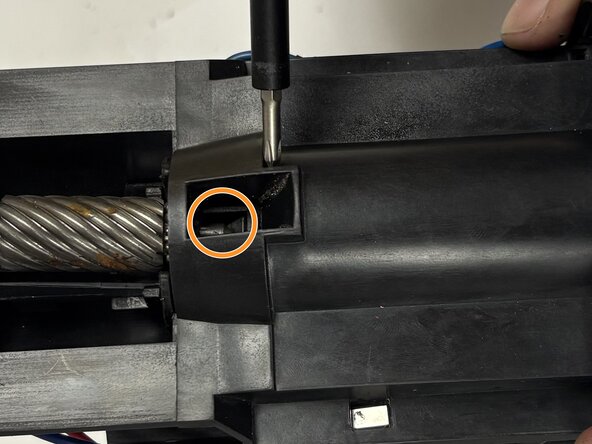

    • Underneath the blades you will see a rectangular opening and a portion of that same rod there as well.
  5. Royal P50 Electric Pencil Sharpener Blades Replacement: crwdns2935265:05crwdnd2935265:01crwdnd2935265:02crwdne2935265:0 Royal P50 Electric Pencil Sharpener Blades Replacement: crwdns2935265:05crwdnd2935265:02crwdnd2935265:02crwdne2935265:0

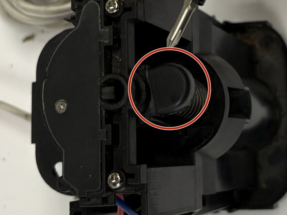

    • Using the same screwdriver you have been using, push that rod upwards by lodging the screwdriver beneath the metal plate, where the rod rests.
    • There should now be a large metallic rod sticking out of the top of the blade.
  6. Royal P50 Electric Pencil Sharpener Blades Replacement: crwdns2935265:06crwdnd2935265:01crwdnd2935265:01crwdne2935265:0

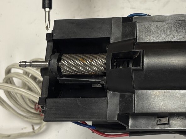

    • Finally, remove the rod and the blade should come right out.
    • Inserting the replacement blades should be done the same way as the process of removal but this time in reverse.
    • Once the blade has been secured, place and screw everything back into it's respective location.
    • And you're done!

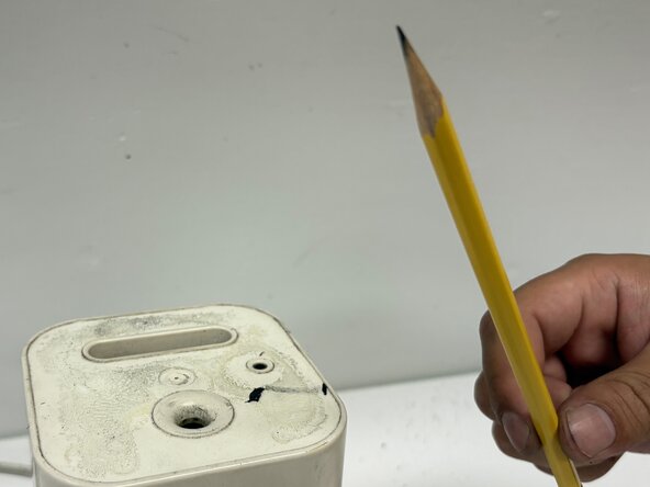

    • Your pencil sharpener should work as good as new now!
    • Happy sharpening!
