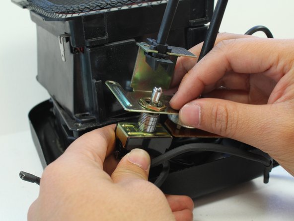

    • Use an adjustable wrench to loosen the nut holding the switch to the metal bracket. Place the wrench around the nut and turn it counter-clockwise.
  11. Royal Heat RS-100 Power/Fan Switch Replacement: crwdns2935265:011crwdnd2935265:01crwdnd2935265:02crwdne2935265:0 Royal Heat RS-100 Power/Fan Switch Replacement: crwdns2935265:011crwdnd2935265:02crwdnd2935265:02crwdne2935265:0
    • Remove the nut by spinning it with your finger and slide the switch off of the gold metal bracket.

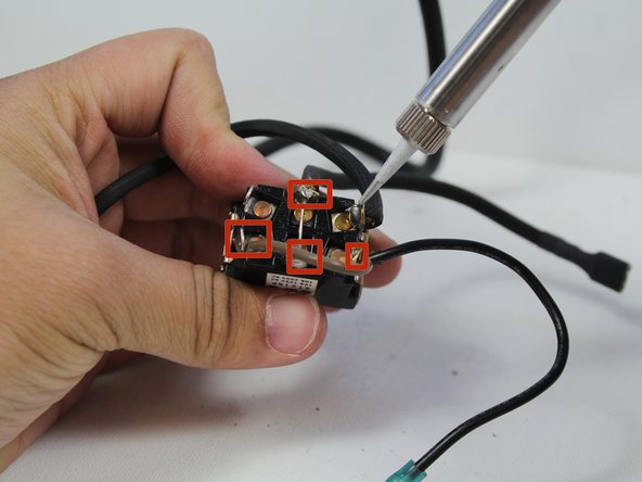

    • Make a diagram of where all the wires are attached to the back of the switch. This will help you re-install them in the correct positions on the replacement switch.
    • Use the soldering iron to remove solder from wires and remove wires from switch.
