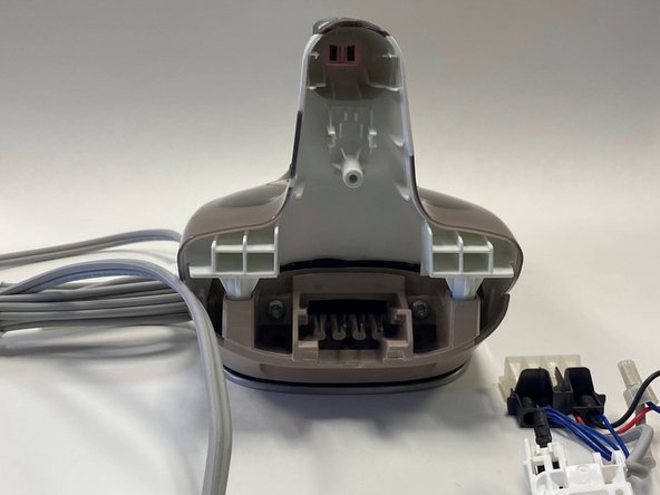

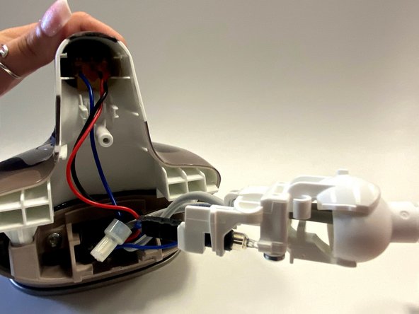

    • Using a T20 screwdriver, remove the 20 mm screw on the back of the iron.
    • Unplug iron before removing cover and make sure the iron is cool before beginning the repair.
  2. Rowenta Focus Power Assembly Replacement: crwdns2935265:02crwdnd2935265:01crwdnd2935265:03crwdne2935265:0 Rowenta Focus Power Assembly Replacement: crwdns2935265:02crwdnd2935265:02crwdnd2935265:03crwdne2935265:0 Rowenta Focus Power Assembly Replacement: crwdns2935265:02crwdnd2935265:03crwdnd2935265:03crwdne2935265:0
    • Pry the back cover of the iron off using a metal spudger.
    • Remove the back cover, exposing the wiring in the iron.
  3. Rowenta Focus Power Assembly Replacement: crwdns2935265:03crwdnd2935265:01crwdnd2935265:02crwdne2935265:0 Rowenta Focus Power Assembly Replacement: crwdns2935265:03crwdnd2935265:02crwdnd2935265:02crwdne2935265:0
    • Remove the frontmost (main) power cord to give access to inner wiring and accessories.
    • Leave the other cords attached to the main cord.
  4. Rowenta Focus Power Assembly Replacement: crwdns2935265:04crwdnd2935265:01crwdnd2935265:02crwdne2935265:0 Rowenta Focus Power Assembly Replacement: crwdns2935265:04crwdnd2935265:02crwdnd2935265:02crwdne2935265:0
    • Pull out the motherboard inside handle of iron.
    • Keep it attached to main power cord and other components.
  5. Rowenta Focus Power Assembly Replacement: crwdns2935265:05crwdnd2935265:01crwdnd2935265:03crwdne2935265:0 Rowenta Focus Power Assembly Replacement: crwdns2935265:05crwdnd2935265:02crwdnd2935265:03crwdne2935265:0 Rowenta Focus Power Assembly Replacement: crwdns2935265:05crwdnd2935265:03crwdnd2935265:03crwdne2935265:0
    • Remove the 4-pronged adaptor from inside the iron by grabbing the black plastic piece and pulling straight out.
To reassemble your device with new power supply, follow these instructions in reverse order.
