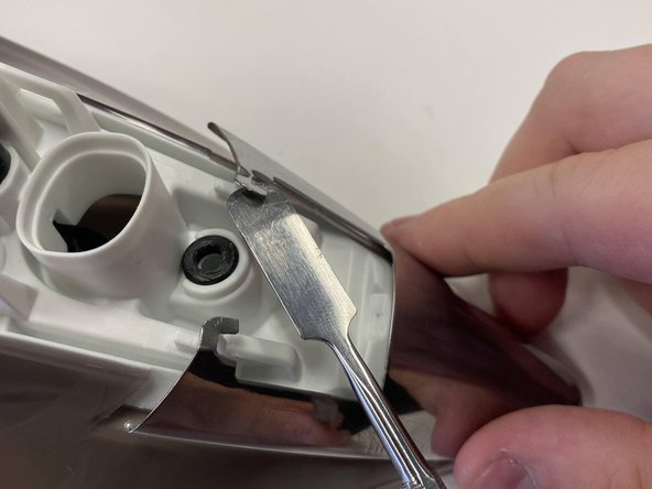

    • Unhook the clips on the top of the metal piece.
    • Using the metal spudger, remove the metal piece on the tip of the iron.

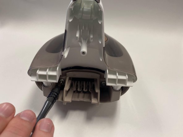

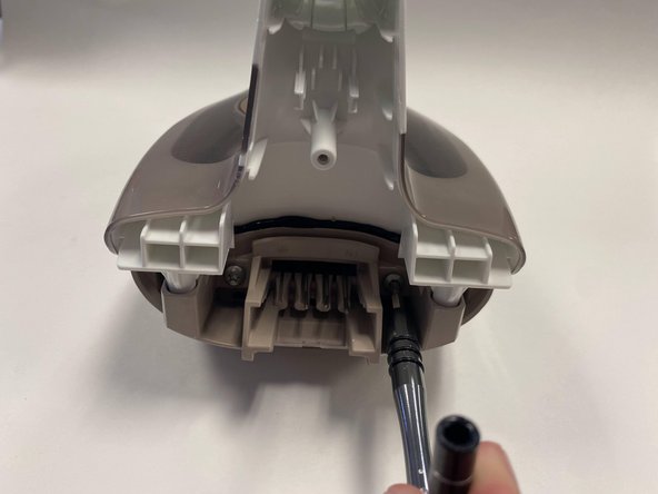

    • Using the T20 screwdriver, remove the two 20 mm screws on either side of the back of the iron.
