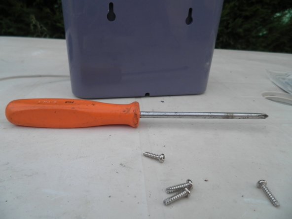

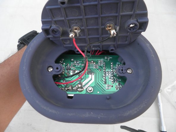

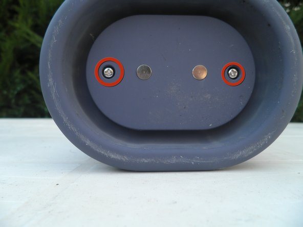

  3. Rowenta AC6221 Teardown: crwdns2935265:03crwdnd2935265:01crwdnd2935265:03crwdne2935265:0 Rowenta AC6221 Teardown: crwdns2935265:03crwdnd2935265:02crwdnd2935265:03crwdne2935265:0 Rowenta AC6221 Teardown: crwdns2935265:03crwdnd2935265:03crwdnd2935265:03crwdne2935265:0
    • Remove the two outer Philips #00 screws from the bottom of the engine.
    • The back of the circuit board will now be visible.

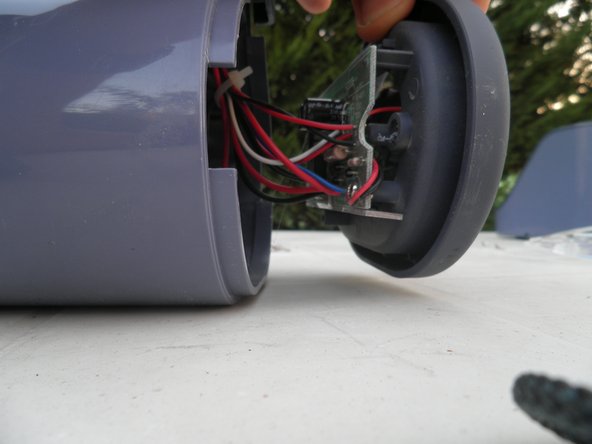

  4. Rowenta AC6221 Teardown: crwdns2935265:04crwdnd2935265:01crwdnd2935265:03crwdne2935265:0 Rowenta AC6221 Teardown: crwdns2935265:04crwdnd2935265:02crwdnd2935265:03crwdne2935265:0 Rowenta AC6221 Teardown: crwdns2935265:04crwdnd2935265:03crwdnd2935265:03crwdne2935265:0
    • Remove the two inner screws.
    • Insert a flat screwdriver between the cover and the base of the engine and remove the cover.
    • The wires of the vacuum are now visible.

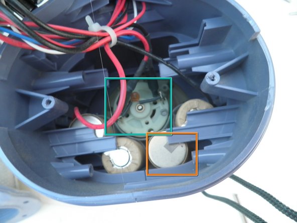

  5. Rowenta AC6221 Teardown: crwdns2935265:06crwdnd2935265:01crwdnd2935265:02crwdne2935265:0 Rowenta AC6221 Teardown: crwdns2935265:06crwdnd2935265:02crwdnd2935265:02crwdne2935265:0
    • The wires connect the charger light, switch,engine, and power wires.
    • The green box labels the engine.
    • The orange box labels one of the four batteries (4*1.2V)

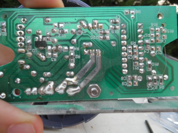

  6. Rowenta AC6221 Teardown: crwdns2935265:07crwdnd2935265:01crwdnd2935265:02crwdne2935265:0 Rowenta AC6221 Teardown: crwdns2935265:07crwdnd2935265:02crwdnd2935265:02crwdne2935265:0
    • The top of the circuit board contains components including capacitors, resistors, wires, and a chip.
    • The bottom side shows the tracks that connect the components.

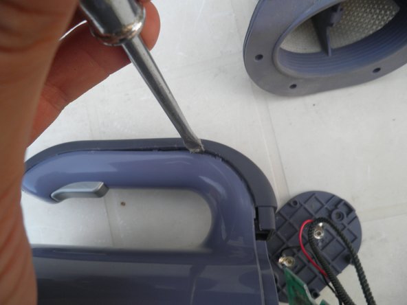

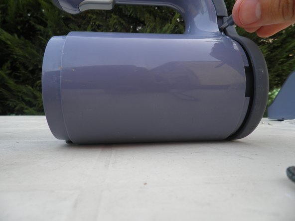

  7. Rowenta AC6221 Teardown: crwdns2935265:08crwdnd2935265:01crwdnd2935265:02crwdne2935265:0 Rowenta AC6221 Teardown: crwdns2935265:08crwdnd2935265:02crwdnd2935265:02crwdne2935265:0
    • Remove the screw securing the handle with a screwdriver.
    • Open the handle to see the inside using the flat screwdriver.
    • Warning: The handle is difficult to open
    • Warning: In this procedure, the handle was not opened to keep the vacuum intact.

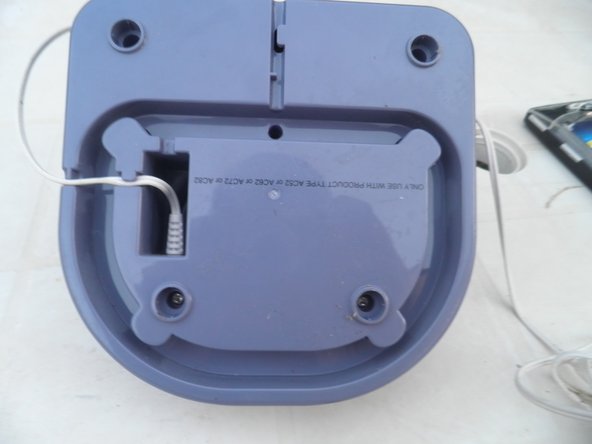

  8. Rowenta AC6221 Teardown: crwdns2935265:09crwdnd2935265:01crwdnd2935265:01crwdne2935265:0
    • This is the pedestal that will be torn down.
  9. Rowenta AC6221 Teardown: crwdns2935265:010crwdnd2935265:01crwdnd2935265:03crwdne2935265:0 Rowenta AC6221 Teardown: crwdns2935265:010crwdnd2935265:02crwdnd2935265:03crwdne2935265:0 Rowenta AC6221 Teardown: crwdns2935265:010crwdnd2935265:03crwdnd2935265:03crwdne2935265:0
    • At the bottom of the pedestal, remove the 4 rubber pieces.
    • Note: This step provides access to 4 Philips screws.
    • Remove screws using a screwdriver.
