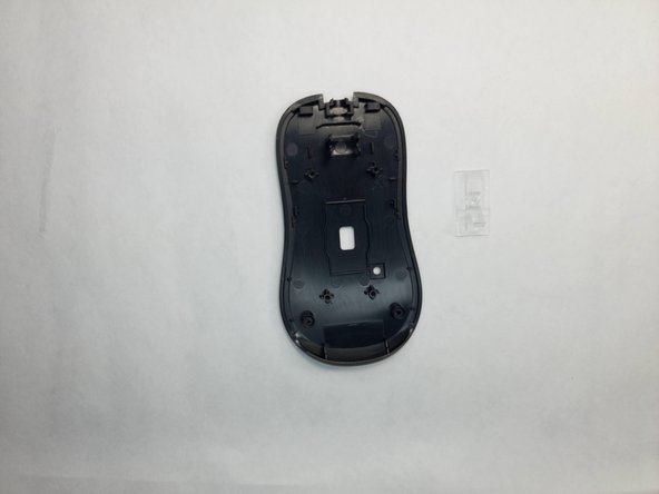

  4. Rosewill NEON M62 Sensor Cover Replacement, Sensor Cover: crwdns2935265:04crwdnd2935265:01crwdnd2935265:01crwdne2935265:0
    • Remove the four 5 mm screws with a Philips #00 screwdriver.
  5. Rosewill NEON M62 Sensor Cover Replacement: crwdns2935265:05crwdnd2935265:01crwdnd2935265:02crwdne2935265:0 Rosewill NEON M62 Sensor Cover Replacement: crwdns2935265:05crwdnd2935265:02crwdnd2935265:02crwdne2935265:0
    • Remove the center clear plastic piece, known as the sensor cover.
