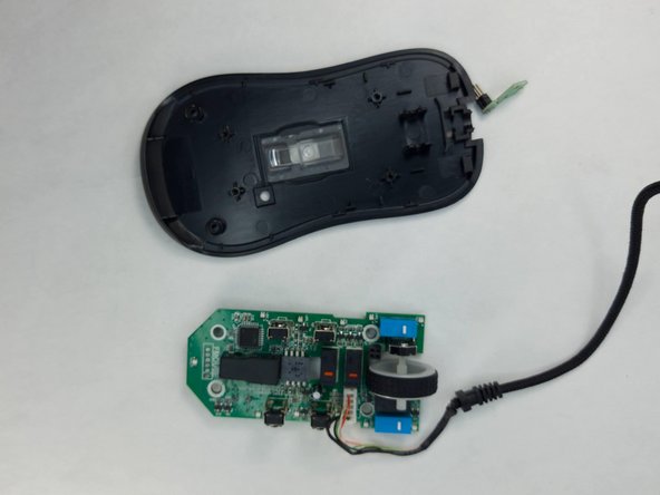

  4. Rosewill NEON M62 Scroll Wheel Replacement, Scroll Wheel RGB Board: crwdns2935265:04crwdnd2935265:01crwdnd2935265:02crwdne2935265:0 Rosewill NEON M62 Scroll Wheel Replacement, Scroll Wheel RGB Board: crwdns2935265:04crwdnd2935265:02crwdnd2935265:02crwdne2935265:0
    • Use the opening tool to push the scroll wheel RGB board up and to the right until it disconnects.

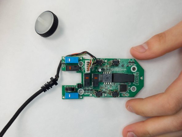

  5. Rosewill NEON M62 Scroll Wheel Replacement, Scroll Wheel: crwdns2935265:05crwdnd2935265:01crwdnd2935265:02crwdne2935265:0 Rosewill NEON M62 Scroll Wheel Replacement, Scroll Wheel: crwdns2935265:05crwdnd2935265:02crwdnd2935265:02crwdne2935265:0
    • Remove the four 5 mm screws from the motherboard using a Phillips #00 screwdriver.
    • Remove the board from the bottom of the mouse.
  6. Rosewill NEON M62 Scroll Wheel Replacement: crwdns2935265:06crwdnd2935265:01crwdnd2935265:02crwdne2935265:0 Rosewill NEON M62 Scroll Wheel Replacement: crwdns2935265:06crwdnd2935265:02crwdnd2935265:02crwdne2935265:0
    • Gently push the wheel up and to the right to remove it from the board.
