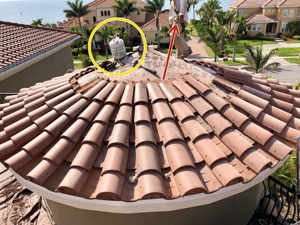

    • Be cautious when climbing the ladder to the roof. Ensure your ladder is secure before climbing.
    • Ensure the damage has not reached the underlayment.

    • Carefully remove the damaged tile(s) using your hammer and crowbar.
    • Be sure to use an effective safety harness when operating in unsafe conditions.

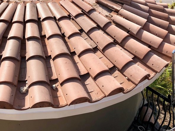

  4. Roofing Tile  Replacement: crwdns2935265:04crwdnd2935265:01crwdnd2935265:01crwdne2935265:0
    • Use roof cement to initially attach the tiles to each other and add security to the underlayment.
    • Be sure to wear the proper gear, such as shoes, hats, & breathable clothing.
  5. Roofing Tile  Replacement: crwdns2935265:05crwdnd2935265:01crwdnd2935265:03crwdne2935265:0 Roofing Tile  Replacement: crwdns2935265:05crwdnd2935265:02crwdnd2935265:03crwdne2935265:0 Roofing Tile  Replacement: crwdns2935265:05crwdnd2935265:03crwdnd2935265:03crwdne2935265:0
    • Secure the tile to the cement by pressing down on the tile using the handle of the hammer.
    • Use the handle of the hammer to maneuver into correct position.
    • As seen in the bottom of the picture, using too much cement can leak out from both sides of the tile. Be sure to keep it as hidden underneath the tile as possible.
    • Safety first. Don't forget to wear a harness and be sure to understand handling of cement take.
  6. Roofing Tile  Replacement: crwdns2935265:06crwdnd2935265:01crwdnd2935265:01crwdne2935265:0
    • Walk carefully on the tiles that are already set into place.

  8. Roofing Tile  Replacement: crwdns2935265:08crwdnd2935265:01crwdnd2935265:01crwdne2935265:0
    • This is an initial point of view for replacing a single broken tile. You can see the application of roof cement in the crevice of the tile.
Number one thing of importance is your safety, my goal is for this guide to give you a general idea of the steps it takes to construct/repair/replace a tile roof.
