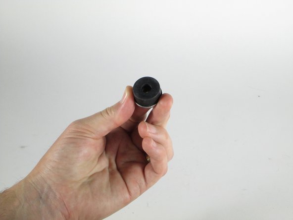

    • Using a 14 mm wrench, loosen and extract the bolt from the base plate.
  2. Roller Skate Double Action Cushion Replacement: crwdns2935265:02crwdnd2935265:01crwdnd2935265:01crwdne2935265:0
    • Once the bolt is no longer in the base plate, lift and twist the entire truck assembly from the skate.
  3. Roller Skate Double Action Cushion Replacement: crwdns2935265:03crwdnd2935265:01crwdnd2935265:02crwdne2935265:0 Roller Skate Double Action Cushion Replacement: crwdns2935265:03crwdnd2935265:02crwdnd2935265:02crwdne2935265:0
    • Flip the truck over and remove the nut from the truck assembly bolt.
  4. Roller Skate Double Action Cushion Replacement: crwdns2935265:04crwdnd2935265:01crwdnd2935265:02crwdne2935265:0 Roller Skate Double Action Cushion Replacement: crwdns2935265:04crwdnd2935265:02crwdnd2935265:02crwdne2935265:0
    • Remove both sets of cushions and retaining washers from the bolt.
  5. Roller Skate Double Action Cushion Replacement: crwdns2935265:05crwdnd2935265:01crwdnd2935265:03crwdne2935265:0 Roller Skate Double Action Cushion Replacement: crwdns2935265:05crwdnd2935265:02crwdnd2935265:03crwdne2935265:0 Roller Skate Double Action Cushion Replacement: crwdns2935265:05crwdnd2935265:03crwdnd2935265:03crwdne2935265:0
    • Remove the retaining washer from each cushion.
    • Use a spudger if the washer and cushion are difficult to separate.
    • Replace worn cushions and washers.
