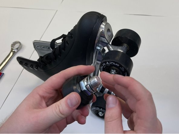

    • Twist and remove the washer, split lock washer, and nut with your hand.
  5. Roller Derby Skate Toe Stop Replacement: crwdns2935265:05crwdnd2935265:01crwdnd2935265:03crwdne2935265:0 Roller Derby Skate Toe Stop Replacement: crwdns2935265:05crwdnd2935265:02crwdnd2935265:03crwdne2935265:0 Roller Derby Skate Toe Stop Replacement: crwdns2935265:05crwdnd2935265:03crwdnd2935265:03crwdne2935265:0

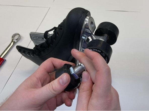

    • Place the nut, split lock washer, and washer on your new toe stop.
  6. Roller Derby Skate Toe Stop Replacement: crwdns2935265:06crwdnd2935265:01crwdnd2935265:01crwdne2935265:0
    • Align the thread of the toe stop screw with the thread on the skate.
    • The threads on the bolt are a soft metal and can bend, chip or break if you force the thread when screwing the toe stop back on.
  7. Roller Derby Skate Toe Stop Replacement: crwdns2935265:07crwdnd2935265:01crwdnd2935265:01crwdne2935265:0
    • Twist the toe stop back on with your hand.
