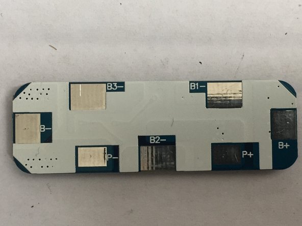

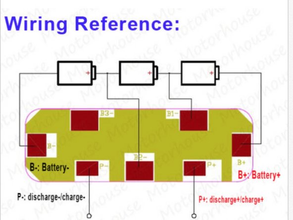

  6. Rollei 6000/6008 Battery LiFePO4 Replacement: crwdns2935265:06crwdnd2935265:01crwdnd2935265:03crwdne2935265:0 Rollei 6000/6008 Battery LiFePO4 Replacement: crwdns2935265:06crwdnd2935265:02crwdnd2935265:03crwdne2935265:0 Rollei 6000/6008 Battery LiFePO4 Replacement: crwdns2935265:06crwdnd2935265:03crwdnd2935265:03crwdne2935265:0
    • The PCB/BMS Board plus wiring diagram
    • The wiring diagram may be different depending on the PCB used. But the principle is the same for all types.

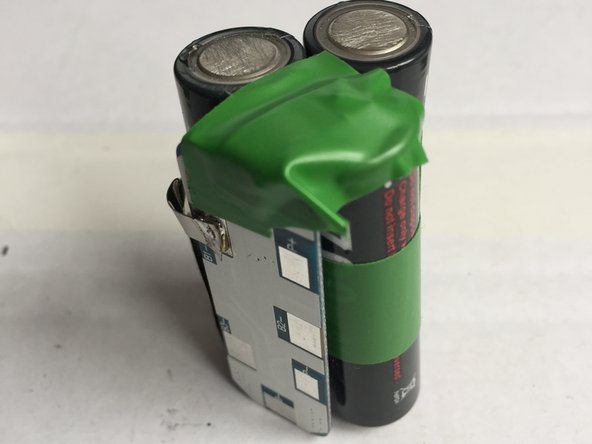

  7. Rollei 6000/6008 Battery LiFePO4 Replacement, Testing the size.: crwdns2935265:07crwdnd2935265:01crwdnd2935265:01crwdne2935265:0
    • Check the size of the battery pack together with the BMS Board. It should easily fit with a bit of space inside the housing. Otherwise you may get problems down the road of this guide.

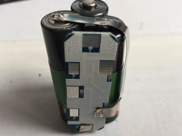

  10. Rollei 6000/6008 Battery LiFePO4 Replacement, Solder B+ on PCB: crwdns2935265:010crwdnd2935265:01crwdnd2935265:03crwdne2935265:0 Rollei 6000/6008 Battery LiFePO4 Replacement, Solder B+ on PCB: crwdns2935265:010crwdnd2935265:02crwdnd2935265:03crwdne2935265:0 Rollei 6000/6008 Battery LiFePO4 Replacement, Solder B+ on PCB: crwdns2935265:010crwdnd2935265:03crwdnd2935265:03crwdne2935265:0
    • Add a bit of solder on the connector you want to use next. I started with B+ and connected it to the + pole of the first battery.
    • Test again if everything fits in the housing.
    • Warning! The housing is metal. Make sure not to short-cut something!

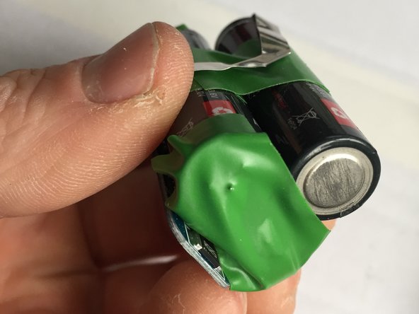

  14. Rollei 6000/6008 Battery LiFePO4 Replacement, More electrical tape: crwdns2935265:014crwdnd2935265:01crwdnd2935265:03crwdne2935265:0 Rollei 6000/6008 Battery LiFePO4 Replacement, More electrical tape: crwdns2935265:014crwdnd2935265:02crwdnd2935265:03crwdne2935265:0 Rollei 6000/6008 Battery LiFePO4 Replacement, More electrical tape: crwdns2935265:014crwdnd2935265:03crwdnd2935265:03crwdne2935265:0
    • Try to isolate but do not cover the writings on the PCB so you can still see, what is already wired.

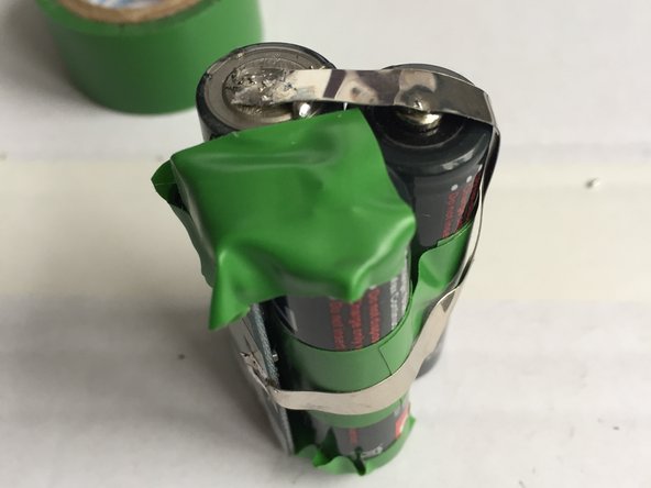

  15. Rollei 6000/6008 Battery LiFePO4 Replacement, Turn around B3: crwdns2935265:015crwdnd2935265:01crwdnd2935265:02crwdne2935265:0 Rollei 6000/6008 Battery LiFePO4 Replacement, Turn around B3: crwdns2935265:015crwdnd2935265:02crwdnd2935265:02crwdne2935265:0
    • It is hard to get the orientation if all batteries correct on first try. But the tape allows cutting and reorientation if needed.
    • This is only needed to use less of the connector and allow easier wiring without crossings

  21. Rollei 6000/6008 Battery LiFePO4 Replacement, Finalising the battery pack: crwdns2935265:021crwdnd2935265:01crwdnd2935265:03crwdne2935265:0 Rollei 6000/6008 Battery LiFePO4 Replacement, Finalising the battery pack: crwdns2935265:021crwdnd2935265:02crwdnd2935265:03crwdne2935265:0 Rollei 6000/6008 Battery LiFePO4 Replacement, Finalising the battery pack: crwdns2935265:021crwdnd2935265:03crwdnd2935265:03crwdne2935265:0
    • Note from the wiring diagram the B3-connector of the PCB is unused.
    • So we add electrical tape to isolate it.
