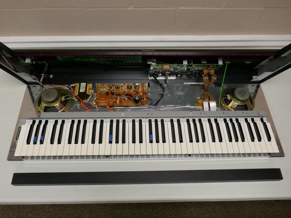

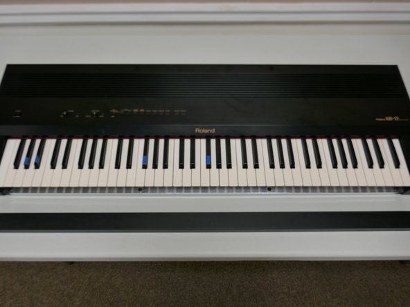

  1. Roland KR-33 Dead Key Repair, Prepare keyboard and work area: crwdns2935265:01crwdnd2935265:01crwdnd2935265:01crwdne2935265:0
    • Perform all maintenance on a large clean surface free of any dust or debris. The extruded aluminum chassis is easily damaged.

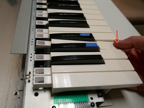

    • Test and mark any affected keys before continuing.
    • Unplug the device. Later steps involve close proximity to exposed electrical components. Proceed at your own risk.
  2. Roland KR-33 Dead Key Repair, Remove lid screws: crwdns2935265:02crwdnd2935265:01crwdnd2935265:03crwdne2935265:0 Roland KR-33 Dead Key Repair, Remove lid screws: crwdns2935265:02crwdnd2935265:02crwdnd2935265:03crwdne2935265:0 Roland KR-33 Dead Key Repair, Remove lid screws: crwdns2935265:02crwdnd2935265:03crwdnd2935265:03crwdne2935265:0

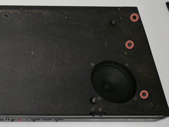

    • Flip the keyboard with the bottom facing up as shown.
    • Remove the 6 screws securing the lid and base plate (3 on each side)
    • The lid can now be opened for basic cleaning. Continue guide for full disassembly.

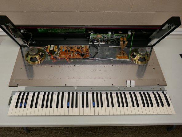

  6. Roland KR-33 Dead Key Repair, Disconnect key panel ribbon cables: crwdns2935265:06crwdnd2935265:01crwdnd2935265:02crwdne2935265:0 Roland KR-33 Dead Key Repair, Disconnect key panel ribbon cables: crwdns2935265:06crwdnd2935265:02crwdnd2935265:02crwdne2935265:0
    • Disconnect the two white ribbon cables to completely free the key panel.
    • The key panel may now be removed from the chassis.

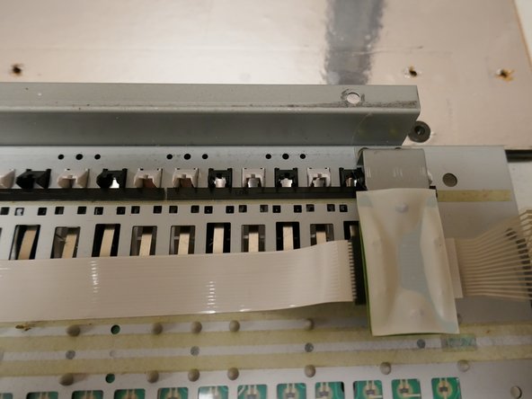

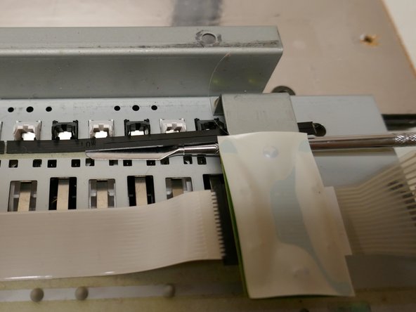

  7. Roland KR-33 Dead Key Repair, Remove key retention strips: crwdns2935265:07crwdnd2935265:01crwdnd2935265:02crwdne2935265:0 Roland KR-33 Dead Key Repair, Remove key retention strips: crwdns2935265:07crwdnd2935265:02crwdnd2935265:02crwdne2935265:0
    • Separate the key panel from the chassis and flip over to see the underside of the keys.
    • Using a spudger, carefully lift the plastic retaining strip(s) for the affected keys.
    • Note: The retention strips are held down with a thin double-stick tape. If damaged it can be replaced later.
    • Note: The length of the key retention strip matches the length of a key-switch membrane.

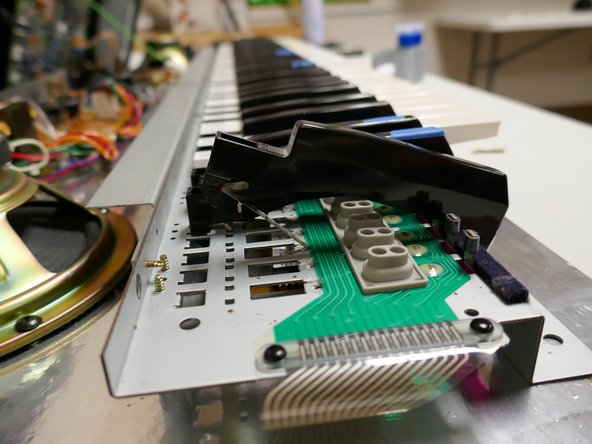

  8. Roland KR-33 Dead Key Repair, Remove affected keys: crwdns2935265:08crwdnd2935265:01crwdnd2935265:02crwdne2935265:0 Roland KR-33 Dead Key Repair, Remove affected keys: crwdns2935265:08crwdnd2935265:02crwdnd2935265:02crwdne2935265:0
    • Turn the key panel back over
    • To remove a key, pull forward slightly then push down. The key will rotate forward and come out of its retention slot.
    • Slide the key backwards to free the leaf spring then pull forward to remove the key entirely.
    • Note: It is easiest to clean/replace the key membranes if all keys on that section are removed first.
    • Note: The white keys must be removed first in order to remove the black keys.

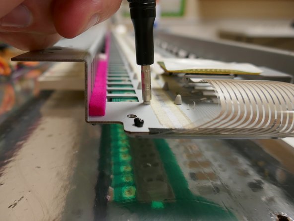

  9. Roland KR-33 Dead Key Repair, Remove key membrane: crwdns2935265:09crwdnd2935265:01crwdnd2935265:03crwdne2935265:0 Roland KR-33 Dead Key Repair, Remove key membrane: crwdns2935265:09crwdnd2935265:02crwdnd2935265:03crwdne2935265:0 Roland KR-33 Dead Key Repair, Remove key membrane: crwdns2935265:09crwdnd2935265:03crwdnd2935265:03crwdne2935265:0
    • Once all keys have been removed on the affected membrane, flip the key panel over.
    • Using a 2.5mm nut driver or similar tool press the tree-shaped retaining stud through the hole. Pull gently from the other side to loosen the membrane.
    • The membrane contacts may now be cleaned with isopropyl alcohol.

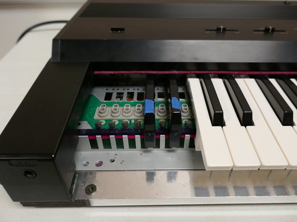

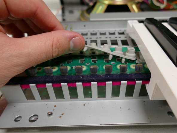

  10. Roland KR-33 Dead Key Repair, Reinstall key membrane.: crwdns2935265:010crwdnd2935265:01crwdnd2935265:01crwdne2935265:0
    • Press the tree-shaped studs back through the board.
    • Note: Use gentle pressure while reinstalling the membrane to avoid tearing it.
    • Note: If additional pressure or guidance is needed press on the center of the stud as shown with a small hex driver or similar implement.
  11. Roland KR-33 Dead Key Repair, Reinstall affected keys: crwdns2935265:011crwdnd2935265:01crwdnd2935265:02crwdne2935265:0 Roland KR-33 Dead Key Repair, Reinstall affected keys: crwdns2935265:011crwdnd2935265:02crwdnd2935265:02crwdne2935265:0
    • Place the key spring back in the appropriate slot as shown.
    • Hook the corresponding key back over the key-spring for installation.
    • Reinstall only the affected keys for testing in the next step.
