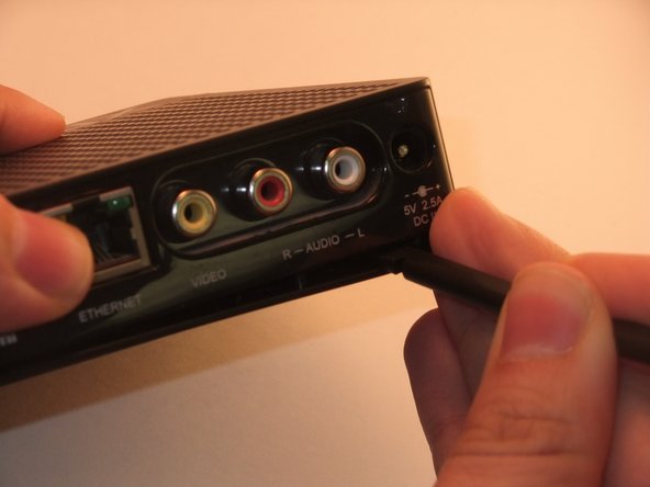

    • Ensure the Roku XDis unplugged.
    • Take care when handling components. Circuit boards, soldering points, and other areas may have sharp points.
    • Turn the device upside down.
    • Remove the two rubber pads using a plastic spudger.

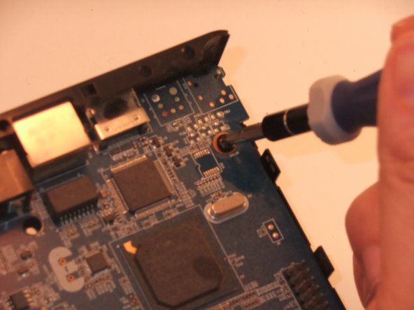

  4. Roku XD 2050X Composite Video Port Replacement: crwdns2935265:04crwdnd2935265:01crwdnd2935265:02crwdne2935265:0 Roku XD 2050X Composite Video Port Replacement: crwdns2935265:04crwdnd2935265:02crwdnd2935265:02crwdne2935265:0
    • Remove the two Phillips #1 8mm pan-head screws.

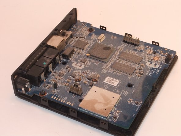

  5. Roku XD 2050X Composite Video Port Replacement: crwdns2935265:05crwdnd2935265:01crwdnd2935265:01crwdne2935265:0
    • On the side of the board opposite the ports, find and tilt back the tab securing the board in place.
    • Lift the motherboard out of the lower frame.
  6. Roku XD 2050X Composite Video Port Replacement, Composite Video Port: crwdns2935265:06crwdnd2935265:01crwdnd2935265:01crwdne2935265:0
    • Desolder the leads for the composite video port that are circled.
    • Remove the video port from the board.
