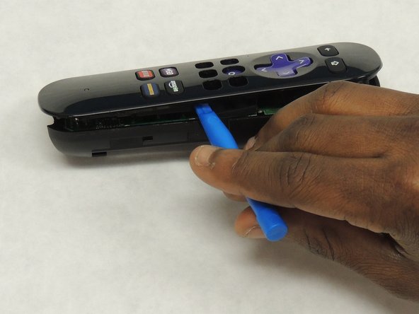

    5. Roku Streaming Stick Macro Button Contacts Replacement: crwdns2935265:05crwdnd2935265:01crwdnd2935265:02crwdne2935265:0 Roku Streaming Stick Macro Button Contacts Replacement: crwdns2935265:05crwdnd2935265:02crwdnd2935265:02crwdne2935265:0
      • Use a plastic opening tool to gently pry apart the plastic enclosure. Make sure you create a large enough gap before you attempt to separate the two pieces.
