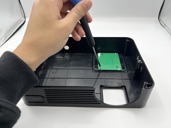

  5. Roconia Q6 OK Button Replacement, OK Button: crwdns2935265:05crwdnd2935265:01crwdnd2935265:02crwdne2935265:0 Roconia Q6 OK Button Replacement, OK Button: crwdns2935265:05crwdnd2935265:02crwdnd2935265:02crwdne2935265:0
    • Use a Phillips #0 screwdriver to remove each of the 5.2 mm screws from the sensor board inside the cover.

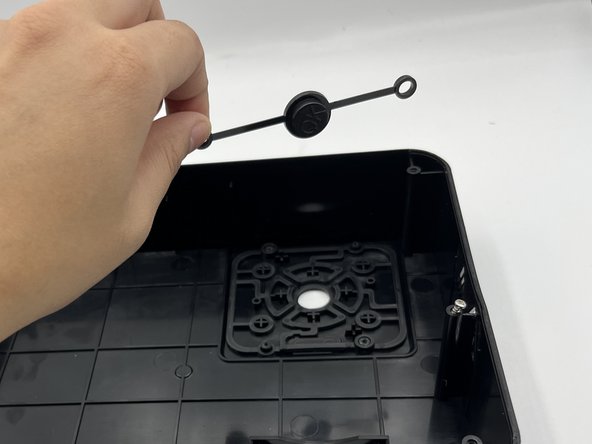

    • Remove the motherboard and you will see the the pieces that help control the buttons.

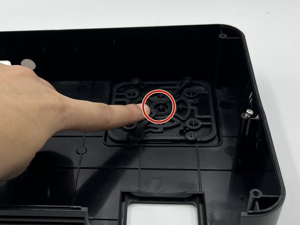

    • Locate where the OK button is placed.
    • Remove the part that helps control the OK button by pulling it out
