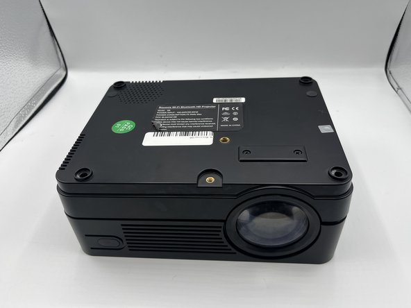

    • Flip your device upside down so that the interface is facing downwards.
  2. Roconia Q6 Lens Replacement: crwdns2935265:02crwdnd2935265:01crwdnd2935265:03crwdne2935265:0 Roconia Q6 Lens Replacement: crwdns2935265:02crwdnd2935265:02crwdnd2935265:03crwdne2935265:0 Roconia Q6 Lens Replacement: crwdns2935265:02crwdnd2935265:03crwdnd2935265:03crwdne2935265:0
    • The device is supported by rubber pieces located at the bottom extremities.
    • There are screws beneath the rubber pieces that can be removed. Remove all four 1.1 mm Phillips #1 screws by using the Phillips #0 screwdriver.

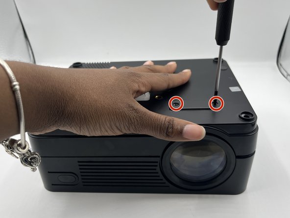

  5. Roconia Q6 Lens Replacement, Lens: crwdns2935265:05crwdnd2935265:01crwdnd2935265:03crwdne2935265:0 Roconia Q6 Lens Replacement, Lens: crwdns2935265:05crwdnd2935265:02crwdnd2935265:03crwdne2935265:0 Roconia Q6 Lens Replacement, Lens: crwdns2935265:05crwdnd2935265:03crwdnd2935265:03crwdne2935265:0
    • Flip roconia over to access screws holding lens in place
    • Remove 7.9 mm screws using a Phillips #0 screwdriver

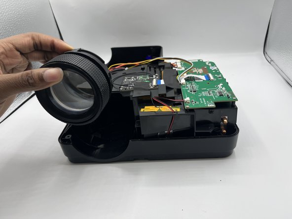

  6. Roconia Q6 Lens Replacement: crwdns2935265:06crwdnd2935265:01crwdnd2935265:02crwdne2935265:0 Roconia Q6 Lens Replacement: crwdns2935265:06crwdnd2935265:02crwdnd2935265:02crwdne2935265:0
    • Flip the roconia back over after removing screws and remove cover
    • Remove lens from holding area and insert replacement
