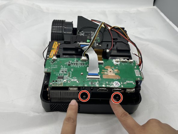

  5. Roconia Q6 Lamp Replacement, Lamp: crwdns2935265:05crwdnd2935265:01crwdnd2935265:03crwdne2935265:0 Roconia Q6 Lamp Replacement, Lamp: crwdns2935265:05crwdnd2935265:02crwdnd2935265:03crwdne2935265:0 Roconia Q6 Lamp Replacement, Lamp: crwdns2935265:05crwdnd2935265:03crwdnd2935265:03crwdne2935265:0

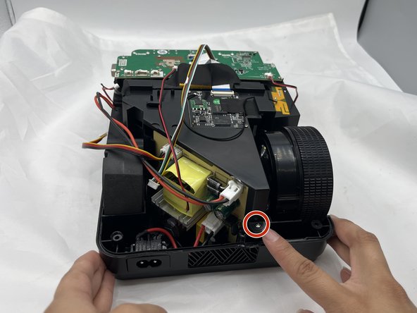

    • We need to locate the screws which are holding down another plastic covering.
    • Use a Phillips #1 screwdriver to remove each of the highlighted 8.8 mm screws.

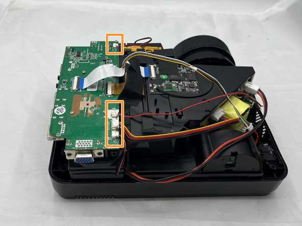

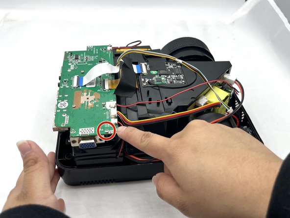

  6. Roconia Q6 Lamp Replacement: crwdns2935265:06crwdnd2935265:01crwdnd2935265:03crwdne2935265:0 Roconia Q6 Lamp Replacement: crwdns2935265:06crwdnd2935265:02crwdnd2935265:03crwdne2935265:0 Roconia Q6 Lamp Replacement: crwdns2935265:06crwdnd2935265:03crwdnd2935265:03crwdne2935265:0
    • There is another screw holding down the plastic covering and it is located on the motherboard. With the same screwdriver, remove that screw.
    • Now carefully pull out the highlighted cables that is connecting to the motherboard that will prevent you from completely removing the plastic cover.

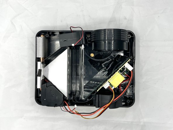

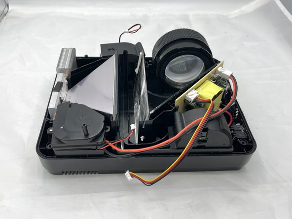

  7. Roconia Q6 Lamp Replacement: crwdns2935265:07crwdnd2935265:01crwdnd2935265:03crwdne2935265:0 Roconia Q6 Lamp Replacement: crwdns2935265:07crwdnd2935265:02crwdnd2935265:03crwdne2935265:0 Roconia Q6 Lamp Replacement: crwdns2935265:07crwdnd2935265:03crwdnd2935265:03crwdne2935265:0
    • From here you will be able to safely remove the plastic covering and expose a second layer of parts.

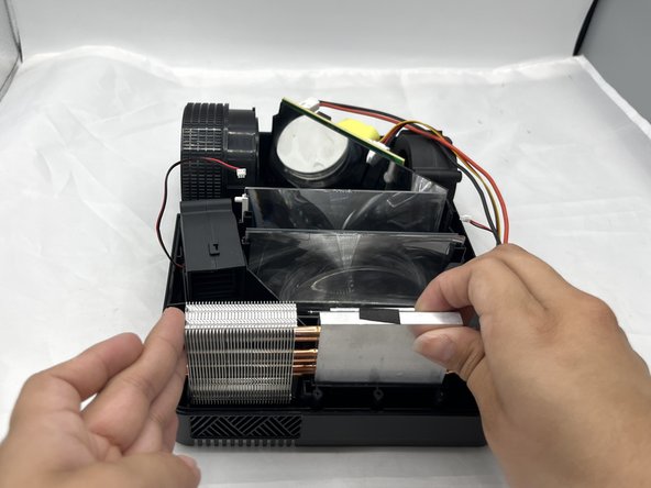

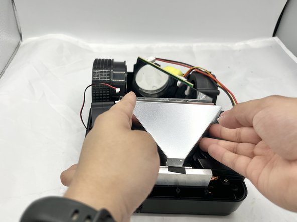

  8. Roconia Q6 Lamp Replacement: crwdns2935265:08crwdnd2935265:01crwdnd2935265:03crwdne2935265:0 Roconia Q6 Lamp Replacement: crwdns2935265:08crwdnd2935265:02crwdnd2935265:03crwdne2935265:0 Roconia Q6 Lamp Replacement: crwdns2935265:08crwdnd2935265:03crwdnd2935265:03crwdne2935265:0
    • We can now locate the lamp which is being held in place by the mirror part.
    • Carefully remove the mirror, without putting any smudges on the inside from our finger.
    • From there you will be able to remove the lamp and replace.
