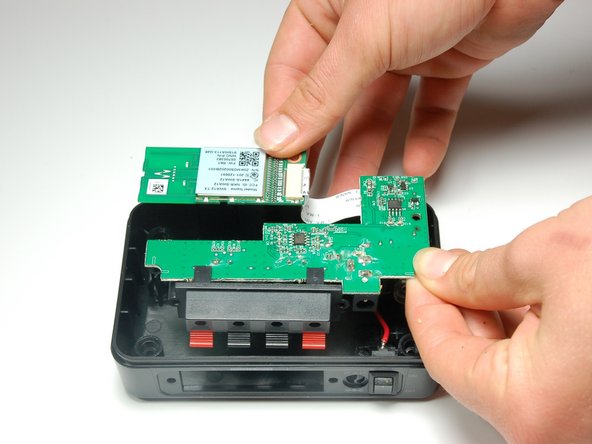

  8. Rocketfish RF-WHTIB-A Sender Wireless Audio Module Chip Replacement: crwdns2935265:08crwdnd2935265:01crwdnd2935265:01crwdne2935265:0
    • Flip over the motherboard and wireless audio module chip.
  9. Rocketfish RF-WHTIB-A Sender Wireless Audio Module Chip Replacement: crwdns2935265:09crwdnd2935265:01crwdnd2935265:01crwdne2935265:0
    • Gently slide the black retaining flap back, securing the ribbon wire gently away from the white bar.
    • There should only be a small separation between the white bar and the black retaining flap.
    • Tweezers are recommended for this step.
  10. Rocketfish RF-WHTIB-A Sender Wireless Audio Module Chip Replacement: crwdns2935265:010crwdnd2935265:01crwdnd2935265:01crwdne2935265:0
    • Using your fingers, pull the ribbon wire out from the black retaining flap in order to completely disconnect the wireless audio module chip.
