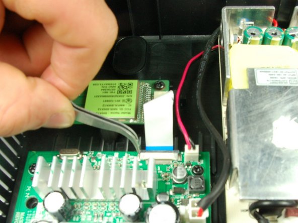

    • Slide the black retaining flap securing the ribbon cable away from the white bar.
    • There should be only a small space between the white bar and black retaining flap.
    • You may want to use tweezers for this step.
  6. Rocketfish RF-WHTIB-A Receiver Wireless Audio Module Chip Replacement: crwdns2935265:06crwdnd2935265:01crwdnd2935265:01crwdne2935265:0
    • Using your fingers, slide the ribbon cable out from the under the black retaining flap to completely disconnect it from the device.
