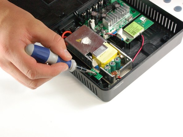

An LED light not working on the Rocketfish RF-WHTIB-A receiver does not necessarily mean the entire device is broken. It could indicate a problem with the LED light chip inside the device, which controls the LED light function. This guide will direct users step by step to replacing a faulty LED light chip.

  4. Rocketfish RF-WHTIB-A Receiver LED Light Chip Replacement, Receiver LED Light Chip: crwdns2935265:04crwdnd2935265:01crwdnd2935265:02crwdne2935265:0 Rocketfish RF-WHTIB-A Receiver LED Light Chip Replacement, Receiver LED Light Chip: crwdns2935265:04crwdnd2935265:02crwdnd2935265:02crwdne2935265:0
    • One 10 mm screw is securing the LED 14.14 chip.
    • Unscrew the chip.
    • Use a Phillips #1 Screwdriver for this step.
