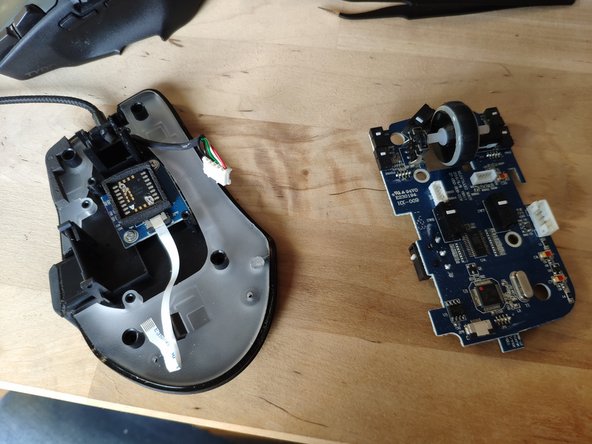

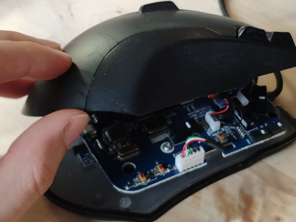

  3. Roccat Tyon omron switch Replacement, separate the top half: crwdns2935265:03crwdnd2935265:01crwdnd2935265:02crwdne2935265:0 Roccat Tyon omron switch Replacement, separate the top half: crwdns2935265:03crwdnd2935265:02crwdnd2935265:02crwdne2935265:0

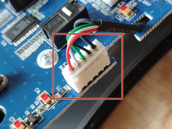

    • Carefully remove the outer shell, the two halves are still connected by wires.
    • remove the white wire connector carefully

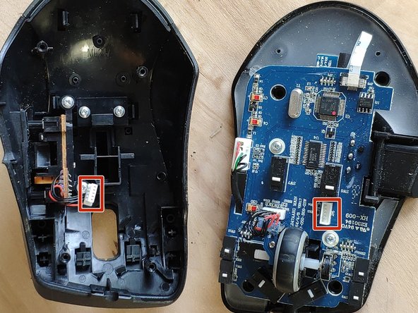

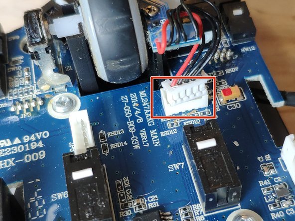

  4. Roccat Tyon omron switch Replacement: crwdns2935265:04crwdnd2935265:01crwdnd2935265:03crwdne2935265:0 Roccat Tyon omron switch Replacement: crwdns2935265:04crwdnd2935265:02crwdnd2935265:03crwdne2935265:0 Roccat Tyon omron switch Replacement: crwdns2935265:04crwdnd2935265:03crwdnd2935265:03crwdne2935265:0

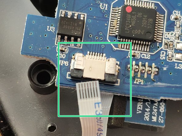

    • unplug the remaining connectors
    • carefully pull-down the Ribbon cable to unplug it

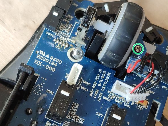

  5. Roccat Tyon omron switch Replacement, free the PCB: crwdns2935265:05crwdnd2935265:01crwdnd2935265:03crwdne2935265:0 Roccat Tyon omron switch Replacement, free the PCB: crwdns2935265:05crwdnd2935265:02crwdnd2935265:03crwdne2935265:0 Roccat Tyon omron switch Replacement, free the PCB: crwdns2935265:05crwdnd2935265:03crwdnd2935265:03crwdne2935265:0
    • remove the last screws and pull the board free
    • the mouse wheel LED assembly is a separate piece you need to unscrew.

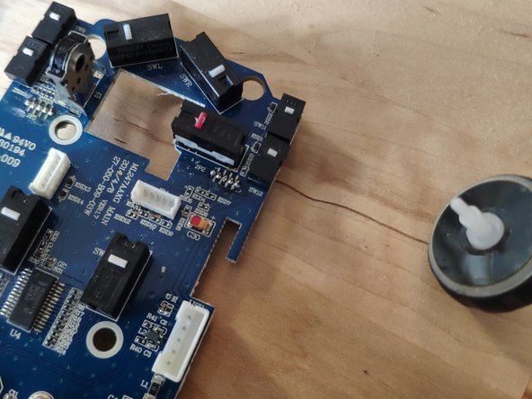

  6. Roccat Tyon omron switch Replacement, remove the mouse wheel: crwdns2935265:06crwdnd2935265:01crwdnd2935265:02crwdne2935265:0 Roccat Tyon omron switch Replacement, remove the mouse wheel: crwdns2935265:06crwdnd2935265:02crwdnd2935265:02crwdne2935265:0
    • you need to pull the mouse wheel to the right to get it out

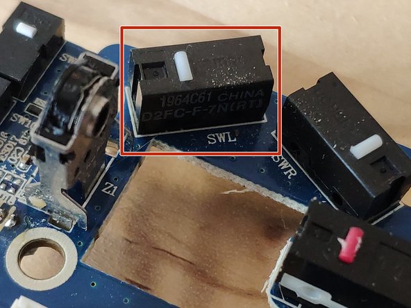

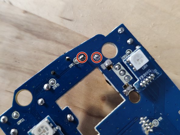

  7. Roccat Tyon omron switch Replacement, remove the old omron switch: crwdns2935265:07crwdnd2935265:01crwdnd2935265:02crwdne2935265:0 Roccat Tyon omron switch Replacement, remove the old omron switch: crwdns2935265:07crwdnd2935265:02crwdnd2935265:02crwdne2935265:0
    • I want to change the left switch.

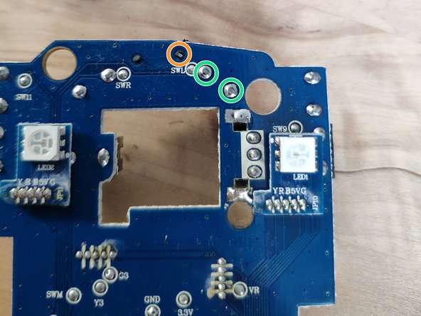

    • flip the board to unsolder the switch.
    • Only two legs are soldered, this is the third one

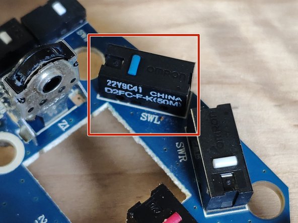

  8. Roccat Tyon omron switch Replacement, solder the new switch: crwdns2935265:08crwdnd2935265:01crwdnd2935265:02crwdne2935265:0 Roccat Tyon omron switch Replacement, solder the new switch: crwdns2935265:08crwdnd2935265:02crwdnd2935265:02crwdne2935265:0
    • The new switch replace the old one not working.
    • The button should be on the left
    • I used a slightly different switch (D2FC-F-K(50M)). The official one is a D2FC-F-7N(RT)
