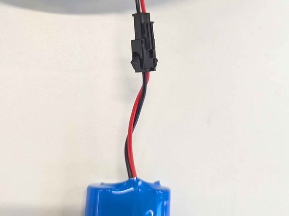

    2. Robot Vacuum Cleaner Disassembly Guide, Removing the Battery: crwdns2935265:02crwdnd2935265:01crwdnd2935265:02crwdne2935265:0 Robot Vacuum Cleaner Disassembly Guide, Removing the Battery: crwdns2935265:02crwdnd2935265:02crwdnd2935265:02crwdne2935265:0
      • Flip the robot upside down with the wheels pointing upwards. Make sure the red power switch is flipped to the off position.
      • Using a small Phillips screwdriver, remove the single screw from the battery cover and slide the cover off.
      • Press the plastic clip in and pull gently to disconnect the battery

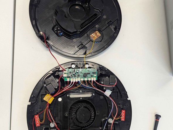

    3. Robot Vacuum Cleaner Disassembly Guide, Detaching the Cover: crwdns2935265:03crwdnd2935265:01crwdnd2935265:02crwdne2935265:0 Robot Vacuum Cleaner Disassembly Guide, Detaching the Cover: crwdns2935265:03crwdnd2935265:02crwdnd2935265:02crwdne2935265:0
      • Lift up on the two brushes from beneath and firmly pull them off the stems.
      • Using a small Phillips screwdriver, remove the 12 screws from the base of the robot.
      • Push down gently on the bumper and pull away from the front to detach.
      • Once the bumper is removed carefully flip the robot back onto its wheels and gently lift the cover off. Take care to not pull on the yellow wire that attaches the start/stop button to the PCB.

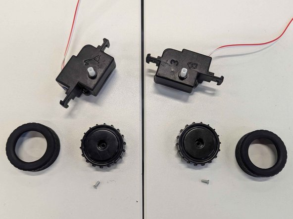

    5. Robot Vacuum Cleaner Disassembly Guide, Removing the Wheel Motors: crwdns2935265:05crwdnd2935265:01crwdnd2935265:02crwdne2935265:0 Robot Vacuum Cleaner Disassembly Guide, Removing the Wheel Motors: crwdns2935265:05crwdnd2935265:02crwdnd2935265:02crwdne2935265:0
      • Pressing gently on the side, carefully remove the 2 pin connection for the motors from the PCB.
      • Using a small Phillips screwdriver, remove the 2 screws holding in the wheel motors. Take care when removing to not lose the springs and washers.
      • Make sure the wire is free and untangled. Once it is free pull the motor out of the robot.
      • Using a small Phillips screwdriver, remove the single screw from the centre of the wheel.
      • Remove the wheel from the shaft. While putting pressure on the plastic wheel, pull the tyre to detach from the wheel.
      • Repeat for the other motor and wheel.

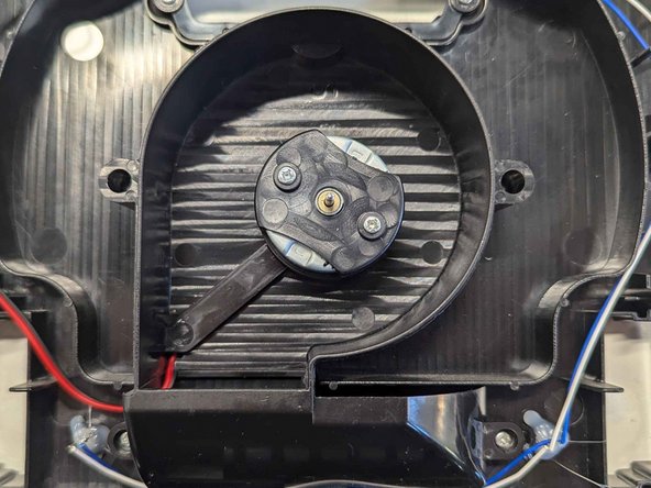

    6. Robot Vacuum Cleaner Disassembly Guide, Disassembling the Fan: crwdns2935265:06crwdnd2935265:01crwdnd2935265:02crwdne2935265:0 Robot Vacuum Cleaner Disassembly Guide, Disassembling the Fan: crwdns2935265:06crwdnd2935265:02crwdnd2935265:02crwdne2935265:0
      • Using a small Phillips screwdriver, remove the single screw from the centre of the fan.
      • Grab around the side of the fan and pull directly upwards to remove from the motor. This may require a decent amount of force.
      • Pressing gently on the side, carefully remove the 2 pin connection for the motor from the PCB.
      • Again using a small Phillips screwdriver, remove the 4 screws from the fan housing.
      • Make sure the motor wire is free and untangled. Once it is free remove the entire housing from the robot.
      • Once the housing is removed, using a small Phillips screwdriver, remove the 2 screws holding in the motor and detach the motor from the housing.

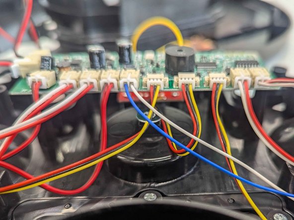

    10. Robot Vacuum Cleaner Disassembly Guide, Removing the PCB: crwdns2935265:010crwdnd2935265:01crwdnd2935265:01crwdne2935265:0
      • Pressing gently on the side, carefully remove the 2 pin connection for the 3 remaining IR sensors. The PCB should now be fully disconnected from all components, aside from the start/stop button for which the connection cannot be removed without soldering.
      • Using a small Phillips screwdriver, remove the 2 screws from the PCB.
      • Placing your fingers on the side to avoid damaging the PCB, lift away from the robot. Be careful to not pull on the yellow wire connecting it to the start/stop button.

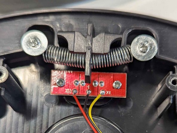

    11. Robot Vacuum Cleaner Disassembly Guide, Removing the IR Sensors: crwdns2935265:011crwdnd2935265:01crwdnd2935265:02crwdne2935265:0 Robot Vacuum Cleaner Disassembly Guide, Removing the IR Sensors: crwdns2935265:011crwdnd2935265:02crwdnd2935265:02crwdne2935265:0
      • Using a small Phillips screwdriver, remove the 2 screws that hold the IR sensor PCB to the robot.
      • Once the PCB has been removed, lift out the plastic covers for the IR sensor from the robot.
      • Repeat for the other 2 IR sensors. Note, the sensor at the front is only accessible once the main PCB has been removed, hence why it was avoided until now.

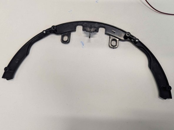

    13. Robot Vacuum Cleaner Disassembly Guide, Removing the Bumper Mechanism: crwdns2935265:013crwdnd2935265:01crwdnd2935265:02crwdne2935265:0 Robot Vacuum Cleaner Disassembly Guide, Removing the Bumper Mechanism: crwdns2935265:013crwdnd2935265:02crwdnd2935265:02crwdne2935265:0
      • Using a small Phillips screwdriver, remove the 4 screws holding in the bumper mechanism.
      • Gently lift the mechanism away from the robot whilst taking care to not lose the springs.
      • Once the springs have been detached, using a small Phillips screwdriver remove the 2 springs from the lower bumper, allowing it to split into 3 separate pieces.

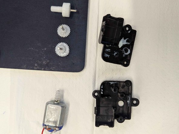

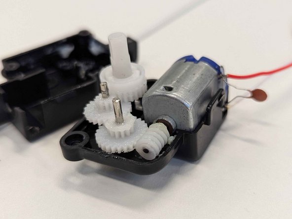

    14. Robot Vacuum Cleaner Disassembly Guide, Disassembling the Motors: crwdns2935265:014crwdnd2935265:01crwdnd2935265:03crwdne2935265:0 Robot Vacuum Cleaner Disassembly Guide, Disassembling the Motors: crwdns2935265:014crwdnd2935265:02crwdnd2935265:03crwdne2935265:0 Robot Vacuum Cleaner Disassembly Guide, Disassembling the Motors: crwdns2935265:014crwdnd2935265:03crwdnd2935265:03crwdne2935265:0
      • Using a small Phillips screwdriver, remove the 2 screws from the motor casing.
      • Pressing firmly in on the clip on the side, lift up the motor cover. Take care when lifting that the output shaft is facing upwards so that the gears do not fall out.
      • Once the casing is opened, carefully lift out each gear and the motor separately. Remove the pin from the centre of each gear.
      • Repeat the same process for the other 3 motors.
    15. Robot Vacuum Cleaner Disassembly Guide, Finished Disassembly: crwdns2935265:015crwdnd2935265:01crwdnd2935265:01crwdne2935265:0
      • When finished, it should look like this.
