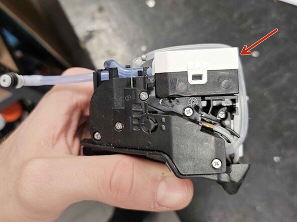

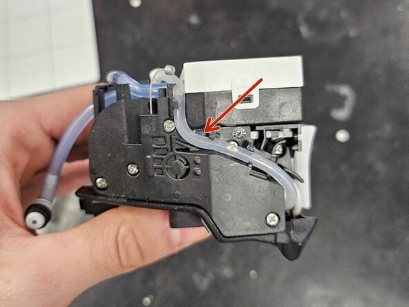

  1. Roborock VibraRise Teardown, Remove the tube out the way: crwdns2935265:01crwdnd2935265:01crwdnd2935265:03crwdne2935265:0 Roborock VibraRise Teardown, Remove the tube out the way: crwdns2935265:01crwdnd2935265:02crwdnd2935265:03crwdne2935265:0 Roborock VibraRise Teardown, Remove the tube out the way: crwdns2935265:01crwdnd2935265:03crwdnd2935265:03crwdne2935265:0
    • Just move it over.
    • You can detach it from the pump, but it's generally unnecesarry.

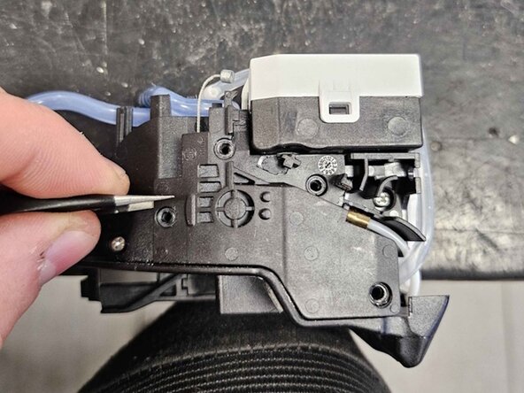

  2. Roborock VibraRise Teardown, Unscrew the screws: crwdns2935265:02crwdnd2935265:01crwdnd2935265:03crwdne2935265:0 Roborock VibraRise Teardown, Unscrew the screws: crwdns2935265:02crwdnd2935265:02crwdnd2935265:03crwdne2935265:0 Roborock VibraRise Teardown, Unscrew the screws: crwdns2935265:02crwdnd2935265:03crwdnd2935265:03crwdne2935265:0
    • Remove the screws, then remove the side panel.

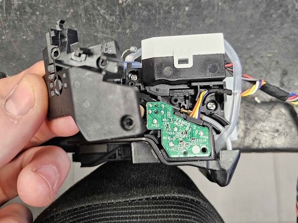

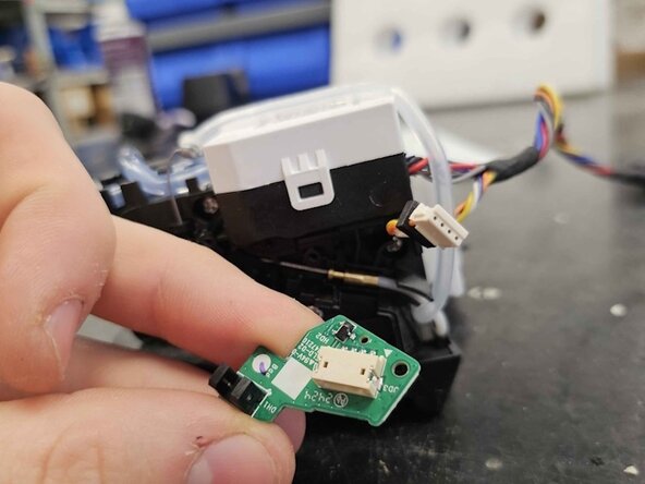

  3. Roborock VibraRise Teardown, Remove the mop detection PCBA: crwdns2935265:03crwdnd2935265:01crwdnd2935265:02crwdne2935265:0 Roborock VibraRise Teardown, Remove the mop detection PCBA: crwdns2935265:03crwdnd2935265:02crwdnd2935265:02crwdne2935265:0
    • Curl it up and remove it from the cable.

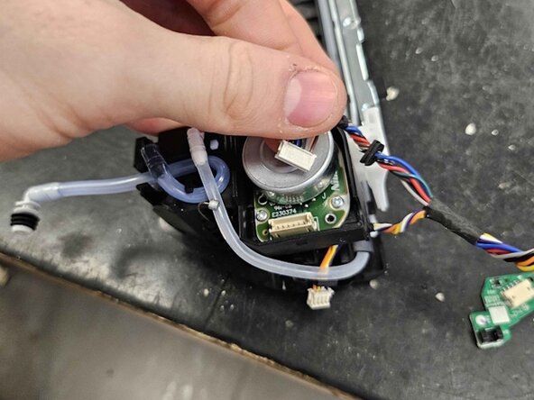

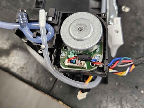

  4. Roborock VibraRise Teardown, Exposing the Motor and it's PCBA: crwdns2935265:04crwdnd2935265:01crwdnd2935265:03crwdne2935265:0 Roborock VibraRise Teardown, Exposing the Motor and it's PCBA: crwdns2935265:04crwdnd2935265:02crwdnd2935265:03crwdne2935265:0 Roborock VibraRise Teardown, Exposing the Motor and it's PCBA: crwdns2935265:04crwdnd2935265:03crwdnd2935265:03crwdne2935265:0
    • Remove the top cover.
    • Remove the cable line.
    • You can remove the motor by hammer the rod out from the top. Before doing this, you will have to open the bottom of the VibraRise unit and detaching the driving rod from the vibrating unit.
    • I don't bother with this, as every time I have, the VibraRise unit didn't work anymore.
