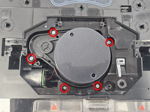

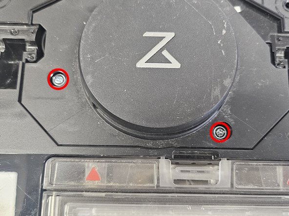

  2. Roborock S7: Cliff sensor replacement, LiDAR: crwdns2935265:02crwdnd2935265:01crwdnd2935265:03crwdne2935265:0 Roborock S7: Cliff sensor replacement, LiDAR: crwdns2935265:02crwdnd2935265:02crwdnd2935265:03crwdne2935265:0 Roborock S7: Cliff sensor replacement, LiDAR: crwdns2935265:02crwdnd2935265:03crwdnd2935265:03crwdne2935265:0
    • Remove the rubber caps covering the 2 screws.
    • Remove the screws.
    • Remove the LiDAR cage.
    • Remove the LiDAR screws, then remove the LiDAR.

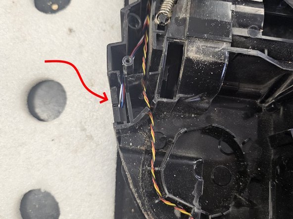

  4. Roborock S7: Cliff sensor replacement, Side brush motor and VibraRise lift wire: crwdns2935265:04crwdnd2935265:01crwdnd2935265:03crwdne2935265:0 Roborock S7: Cliff sensor replacement, Side brush motor and VibraRise lift wire: crwdns2935265:04crwdnd2935265:02crwdnd2935265:03crwdne2935265:0 Roborock S7: Cliff sensor replacement, Side brush motor and VibraRise lift wire: crwdns2935265:04crwdnd2935265:03crwdnd2935265:03crwdne2935265:0
    • Continue by removing the side brush motor.
    • Move further below, then remove the screws. The 2 holes marked by arrows have screws within them. The smaller screws are PH1 and the bigger are PH2. After removing the screws, remove the side panel.
    • Remove the wire from the plastic housing. Angled tweezers recommended.

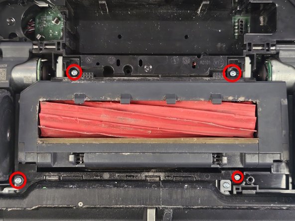

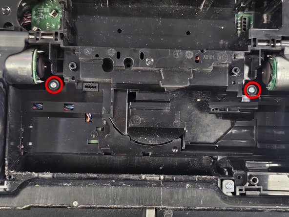

  6. Roborock S7: Cliff sensor replacement, Chassis and main brush: crwdns2935265:06crwdnd2935265:01crwdnd2935265:03crwdne2935265:0 Roborock S7: Cliff sensor replacement, Chassis and main brush: crwdns2935265:06crwdnd2935265:02crwdnd2935265:03crwdne2935265:0 Roborock S7: Cliff sensor replacement, Chassis and main brush: crwdns2935265:06crwdnd2935265:03crwdnd2935265:03crwdne2935265:0

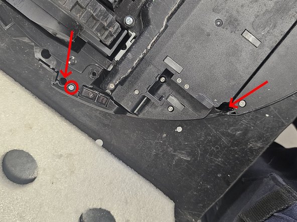

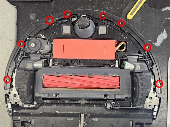

    • Remove the screws marked in image 1.
    • Now remove the screws in image 2, then remove the main brush assembly. There is no need to remove the brush cover or the brush itself. You simply pull it out.
    • Remove the 2 screws hidden by the main brush assembly.

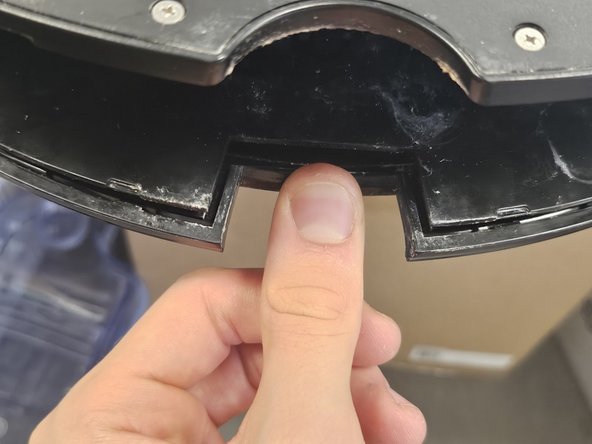

  7. Roborock S7: Cliff sensor replacement, Latches on the back: crwdns2935265:07crwdnd2935265:01crwdnd2935265:02crwdne2935265:0 Roborock S7: Cliff sensor replacement, Latches on the back: crwdns2935265:07crwdnd2935265:02crwdnd2935265:02crwdne2935265:0
    • Unlatch these 2 latches.

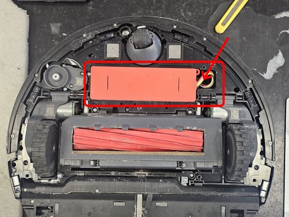

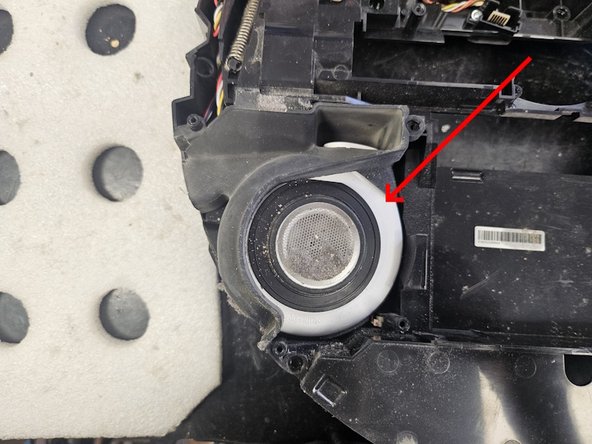

  9. Roborock S7: Cliff sensor replacement, Diagnose the faulty cliff sensor: crwdns2935265:09crwdnd2935265:01crwdnd2935265:03crwdne2935265:0 Roborock S7: Cliff sensor replacement, Diagnose the faulty cliff sensor: crwdns2935265:09crwdnd2935265:02crwdnd2935265:03crwdne2935265:0 Roborock S7: Cliff sensor replacement, Diagnose the faulty cliff sensor: crwdns2935265:09crwdnd2935265:03crwdnd2935265:03crwdne2935265:0
    • Begin by finding out which of your cliff sensors is dead. I don't have a scientific method here, but I start by checking the one that is most commonly faulty.
    • It's the cliff sensor that is next to the suction fan. Remove the suction fan cover, then the suction fan itself.
    • The reason this one is usually faulty is: If the suction fan swallows any water at all, some amount will almost certainly land within this cliff sensor, causing damage.

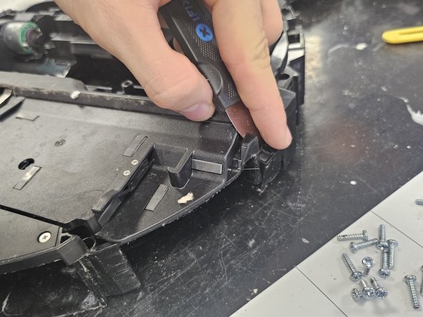

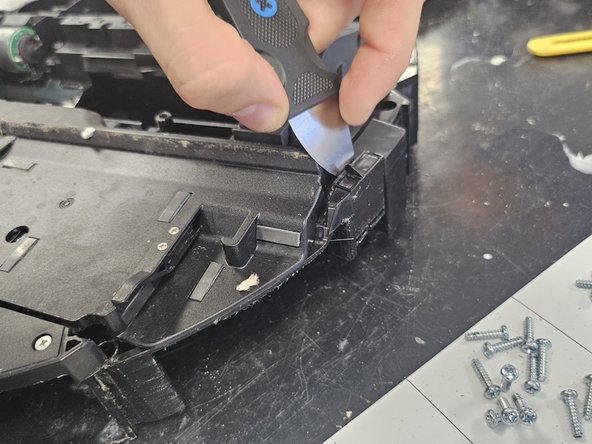

  10. Roborock S7: Cliff sensor replacement, Remove the cliff sensor: crwdns2935265:010crwdnd2935265:01crwdnd2935265:03crwdne2935265:0 Roborock S7: Cliff sensor replacement, Remove the cliff sensor: crwdns2935265:010crwdnd2935265:02crwdnd2935265:03crwdne2935265:0 Roborock S7: Cliff sensor replacement, Remove the cliff sensor: crwdns2935265:010crwdnd2935265:03crwdnd2935265:03crwdne2935265:0
    • Slip something thin in the gap. If you own an iFixit Jimmy, this is where it comes in very handy.
    • You can also use a hammer to tap the cliff sensor out of place, but that risks breaking the plastic housing.

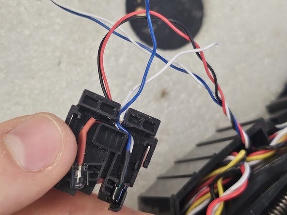

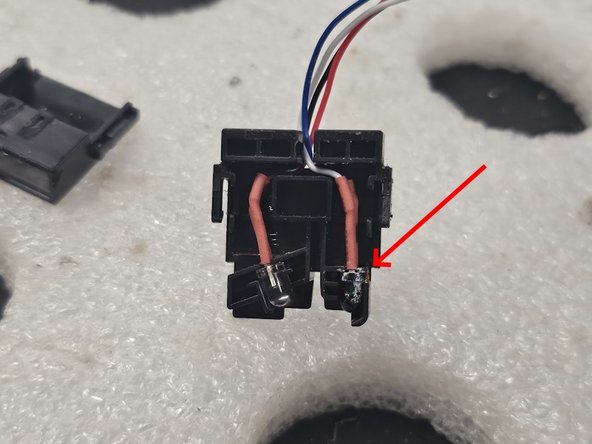

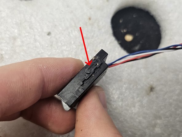

  11. Roborock S7: Cliff sensor replacement, Disassemble the cliff sensor: crwdns2935265:011crwdnd2935265:01crwdnd2935265:03crwdne2935265:0 Roborock S7: Cliff sensor replacement, Disassemble the cliff sensor: crwdns2935265:011crwdnd2935265:02crwdnd2935265:03crwdne2935265:0 Roborock S7: Cliff sensor replacement, Disassemble the cliff sensor: crwdns2935265:011crwdnd2935265:03crwdnd2935265:03crwdne2935265:0
    • Take the cliff sensor apart. It is held together by 2 latches on both sides. Fold those out, then slide the 2 halves apart.
    • In my case, the damage was apparent.
  12. Roborock S7: Cliff sensor replacement, Replace the damaged part, then reassemble the sensor: crwdns2935265:012crwdnd2935265:01crwdnd2935265:02crwdne2935265:0 Roborock S7: Cliff sensor replacement, Replace the damaged part, then reassemble the sensor: crwdns2935265:012crwdnd2935265:02crwdnd2935265:02crwdne2935265:0
    • Prepare a replacement and fit it into the cliff sensor assembly.
    • Once you have it fitted properly, re-assemble the cliff sensor chassis.

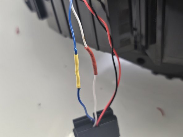

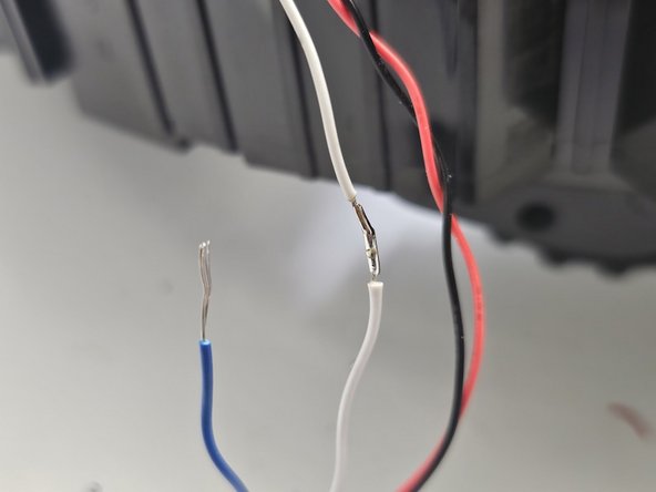

  14. Roborock S7: Cliff sensor replacement, Soldering: crwdns2935265:014crwdnd2935265:01crwdnd2935265:03crwdne2935265:0 Roborock S7: Cliff sensor replacement, Soldering: crwdns2935265:014crwdnd2935265:02crwdnd2935265:03crwdne2935265:0 Roborock S7: Cliff sensor replacement, Soldering: crwdns2935265:014crwdnd2935265:03crwdnd2935265:03crwdne2935265:0
    • Now the fun part: Soldering!
    • Solder the wires together, in my case it was simple. Blue on blue, white on white.
    • I think (but I am not certain, as I am not an electrician) that white is the positive while blue is the negative. Or it might not matter at all. I don't know.
    • This is a pretty low difficulty soldering task.
