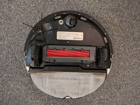

  1. Roborock S7 Max Ultra Main Brush Replacement, Lay the Device on its Back: crwdns2935265:01crwdnd2935265:01crwdnd2935265:02crwdne2935265:0 Roborock S7 Max Ultra Main Brush Replacement, Lay the Device on its Back: crwdns2935265:01crwdnd2935265:02crwdnd2935265:02crwdne2935265:0
    • Lay the device on its back to access the underside.

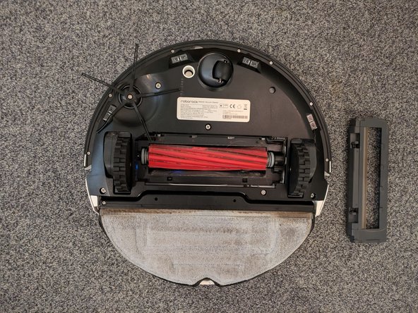

  2. Roborock S7 Max Ultra Main Brush Replacement, Remove the Brush Cover: crwdns2935265:02crwdnd2935265:01crwdnd2935265:02crwdne2935265:0 Roborock S7 Max Ultra Main Brush Replacement, Remove the Brush Cover: crwdns2935265:02crwdnd2935265:02crwdnd2935265:02crwdne2935265:0
    • Remove the main brush cover by pressing the two small latches and pulling the cover off.
    • When reassembling, ensure the notches on the top side of the frame are properly aligned and seated.

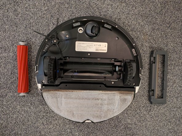

  3. Roborock S7 Max Ultra Main Brush Replacement, Remove the Brush: crwdns2935265:03crwdnd2935265:01crwdnd2935265:02crwdne2935265:0 Roborock S7 Max Ultra Main Brush Replacement, Remove the Brush: crwdns2935265:03crwdnd2935265:02crwdnd2935265:02crwdne2935265:0
    • Take out the main brush.
    • The main brush is directionally keyed, meaning it only fits one way. The rectangular side must be inserted into the motor side.
