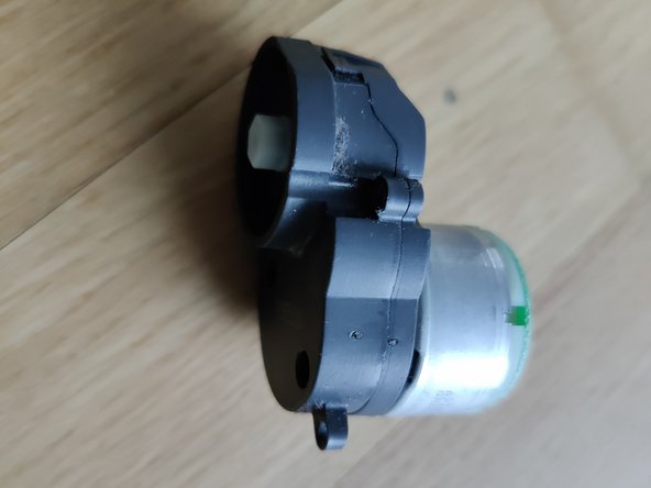

  4. Roborock S5 Series Sidebrush Motor Replacement, Remove gearbox with motor: crwdns2935265:04crwdnd2935265:01crwdnd2935265:02crwdne2935265:0 Roborock S5 Series Sidebrush Motor Replacement, Remove gearbox with motor: crwdns2935265:04crwdnd2935265:02crwdnd2935265:02crwdne2935265:0
    • Remove the 3 screws holding the gearbox in place and lift it out.

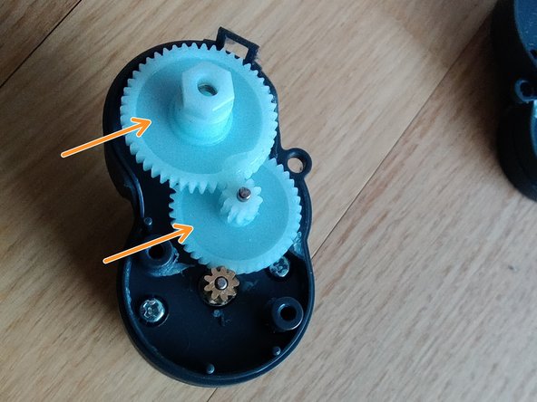

  5. Roborock S5 Series Sidebrush Motor Replacement, Open the gearbox: crwdns2935265:05crwdnd2935265:01crwdnd2935265:02crwdne2935265:0 Roborock S5 Series Sidebrush Motor Replacement, Open the gearbox: crwdns2935265:05crwdnd2935265:02crwdnd2935265:02crwdne2935265:0
    • Remove the 2 screws of the gearbox.
    • Carefully lift of the lid (try not to break the clip or loose the gears)
    • Pull the 2 white plastic gear wheels off to the top (potentially inspect those for damage while it's open anyway).

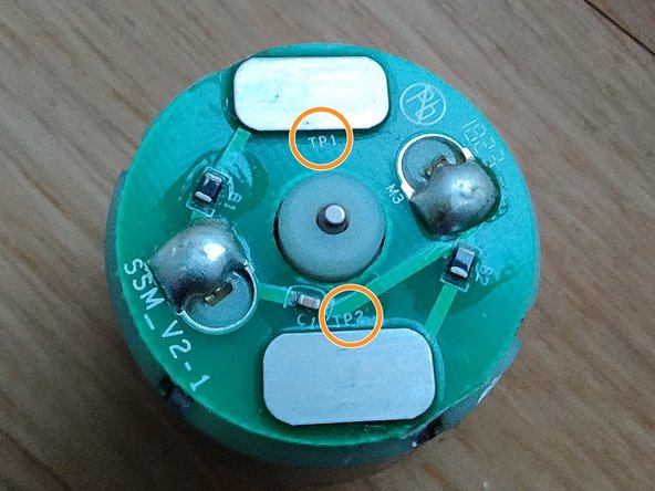

  6. Roborock S5 Series Sidebrush Motor Replacement, Remove the motor: crwdns2935265:06crwdnd2935265:01crwdnd2935265:02crwdne2935265:0 Roborock S5 Series Sidebrush Motor Replacement, Remove the motor: crwdns2935265:06crwdnd2935265:02crwdnd2935265:02crwdne2935265:0
    • Check the orientation on the motor by looking at it from the back. Note the TP1 and TP2 markers on the PCB.
    • Remove 2 screws holding the motor in place.
    • Pull it off to the back.
