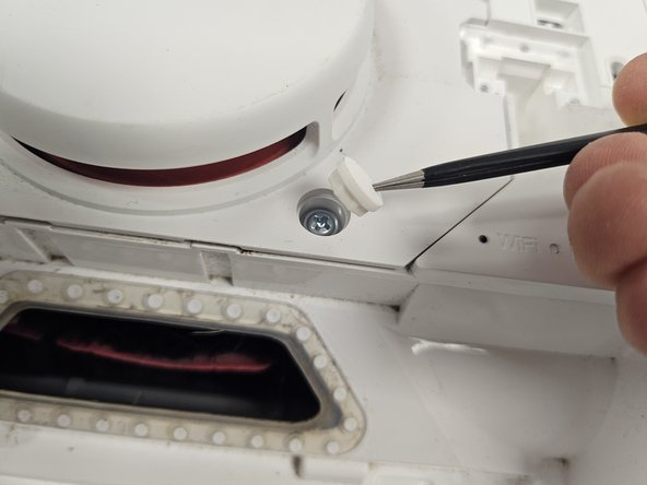

  2. Roborock S5 Max: Motherboard Replacement, Remove the rubber caps.: crwdns2935265:02crwdnd2935265:01crwdnd2935265:02crwdne2935265:0 Roborock S5 Max: Motherboard Replacement, Remove the rubber caps.: crwdns2935265:02crwdnd2935265:02crwdnd2935265:02crwdne2935265:0
    • Remove the rubber caps.
    • There are multiple techniques to do this, but I usually just stab them with sharp tipped tweezers. You could slip them in between the housing and the rubber cap as well.

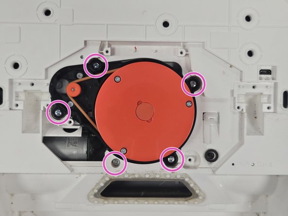

  3. Roborock S5 Max: Motherboard Replacement, Remove the Lidar.: crwdns2935265:03crwdnd2935265:01crwdnd2935265:02crwdne2935265:0 Roborock S5 Max: Motherboard Replacement, Remove the Lidar.: crwdns2935265:03crwdnd2935265:02crwdnd2935265:02crwdne2935265:0
    • Remove the screws of the LiDAR cage, then the cage itself.
    • Remove the screws of the LiDAR, then the LiDAR itself.

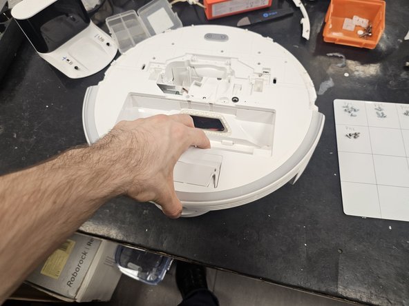

  5. Roborock S5 Max: Motherboard Replacement, Remove the bottom cover.: crwdns2935265:05crwdnd2935265:01crwdnd2935265:01crwdne2935265:0
    • Remove the side brush.
    • Remove the screws.
    • Lift the bottom cover off.

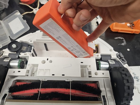

  7. Roborock S5 Max: Motherboard Replacement, Remove the battery.: crwdns2935265:07crwdnd2935265:01crwdnd2935265:03crwdne2935265:0 Roborock S5 Max: Motherboard Replacement, Remove the battery.: crwdns2935265:07crwdnd2935265:02crwdnd2935265:03crwdne2935265:0 Roborock S5 Max: Motherboard Replacement, Remove the battery.: crwdns2935265:07crwdnd2935265:03crwdnd2935265:03crwdne2935265:0
    • Grab it by the tab, then lift it out, tilting it towards the cable.
    • Once you can reach it, squeeze the connector to release it.
    • Don't tear the connector off the motherboard by yanking the battery out.

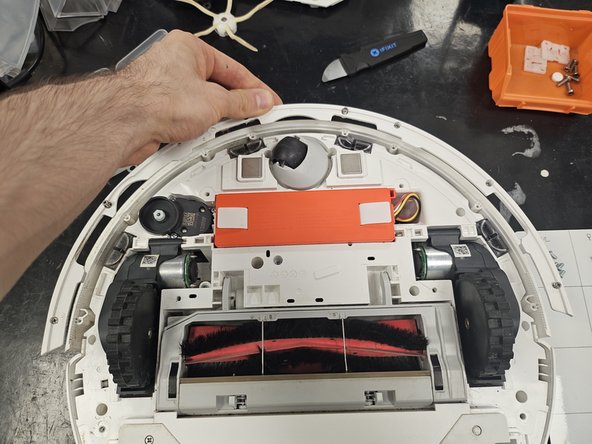

  8. Roborock S5 Max: Motherboard Replacement, Remove the side brush motor and the chassis screws.: crwdns2935265:08crwdnd2935265:01crwdnd2935265:02crwdne2935265:0 Roborock S5 Max: Motherboard Replacement, Remove the side brush motor and the chassis screws.: crwdns2935265:08crwdnd2935265:02crwdnd2935265:02crwdne2935265:0
    • Remove the screws from the side brush motor.
    • Simply lift it out.
    • Remove the rest of the screws from the chassis.

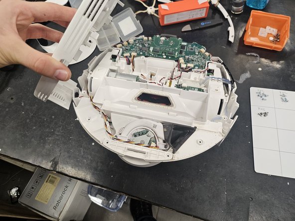

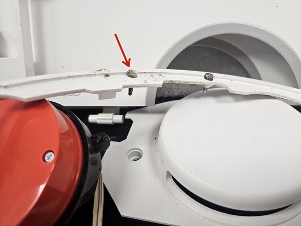

  9. Roborock S5 Max: Motherboard Replacement, Take the chassis apart.: crwdns2935265:09crwdnd2935265:01crwdnd2935265:03crwdne2935265:0 Roborock S5 Max: Motherboard Replacement, Take the chassis apart.: crwdns2935265:09crwdnd2935265:02crwdnd2935265:03crwdne2935265:0 Roborock S5 Max: Motherboard Replacement, Take the chassis apart.: crwdns2935265:09crwdnd2935265:03crwdnd2935265:03crwdne2935265:0
    • Remove the final 4 screws (these are non-magnetic).
    • Flip it over, then pull the chassis apart.

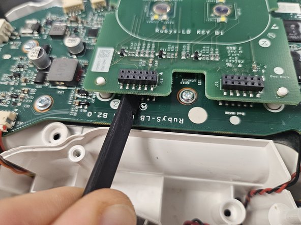

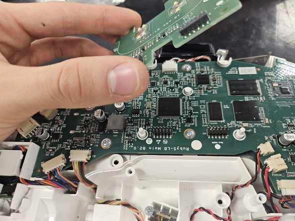

  11. Roborock S5 Max: Motherboard Replacement, Remove the PCBA that houses the buttons.: crwdns2935265:011crwdnd2935265:01crwdnd2935265:03crwdne2935265:0 Roborock S5 Max: Motherboard Replacement, Remove the PCBA that houses the buttons.: crwdns2935265:011crwdnd2935265:02crwdnd2935265:03crwdne2935265:0 Roborock S5 Max: Motherboard Replacement, Remove the PCBA that houses the buttons.: crwdns2935265:011crwdnd2935265:03crwdnd2935265:03crwdne2935265:0
    • Use a plastic spudger to dislodge it, then take it off.

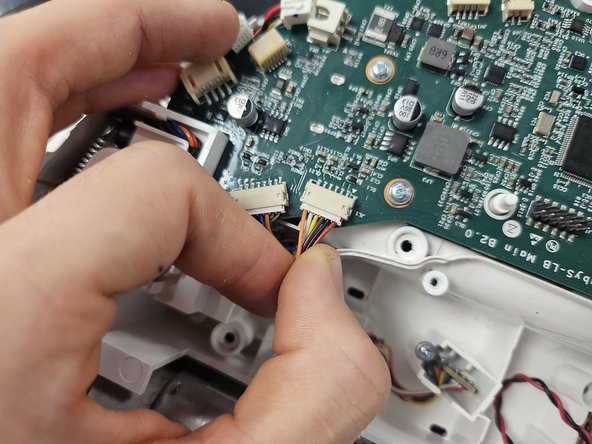

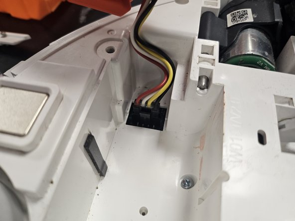

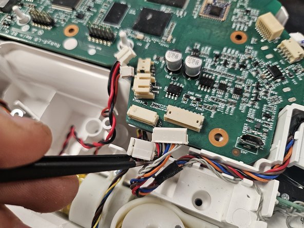

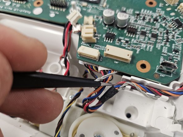

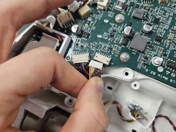

  12. Roborock S5 Max: Motherboard Replacement, Remove the connectors: crwdns2935265:012crwdnd2935265:01crwdnd2935265:03crwdne2935265:0 Roborock S5 Max: Motherboard Replacement, Remove the connectors: crwdns2935265:012crwdnd2935265:02crwdnd2935265:03crwdne2935265:0 Roborock S5 Max: Motherboard Replacement, Remove the connectors: crwdns2935265:012crwdnd2935265:03crwdnd2935265:03crwdne2935265:0
    • Disconnect all of the connectors.
    • Some of them are more finnicky, and will require you to rock them left to right while pulling them slightly.

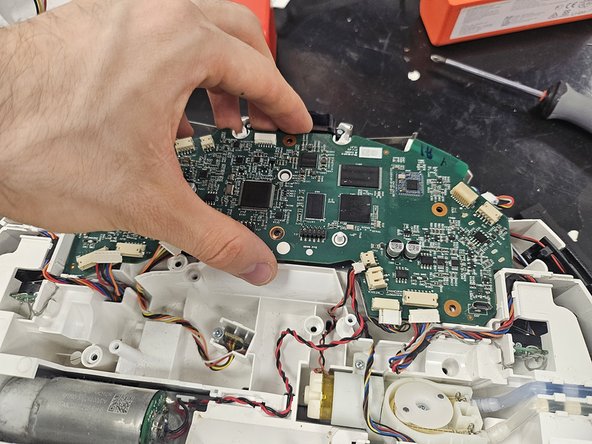

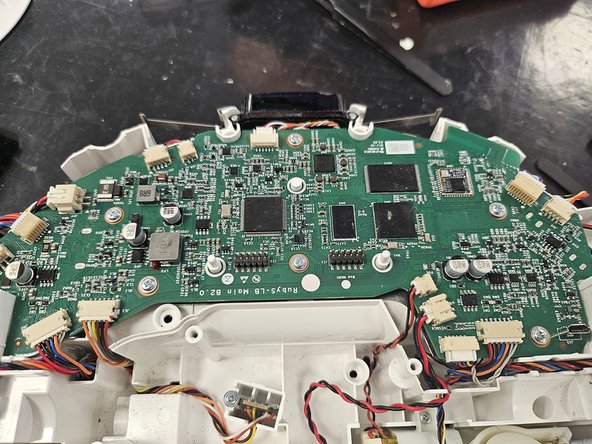

  13. Roborock S5 Max: Motherboard Replacement, Remove the motherboard: crwdns2935265:013crwdnd2935265:01crwdnd2935265:03crwdne2935265:0 Roborock S5 Max: Motherboard Replacement, Remove the motherboard: crwdns2935265:013crwdnd2935265:02crwdnd2935265:03crwdne2935265:0 Roborock S5 Max: Motherboard Replacement, Remove the motherboard: crwdns2935265:013crwdnd2935265:03crwdnd2935265:03crwdne2935265:0
    • Remove the screws from the motherboard.
    • Take it out.

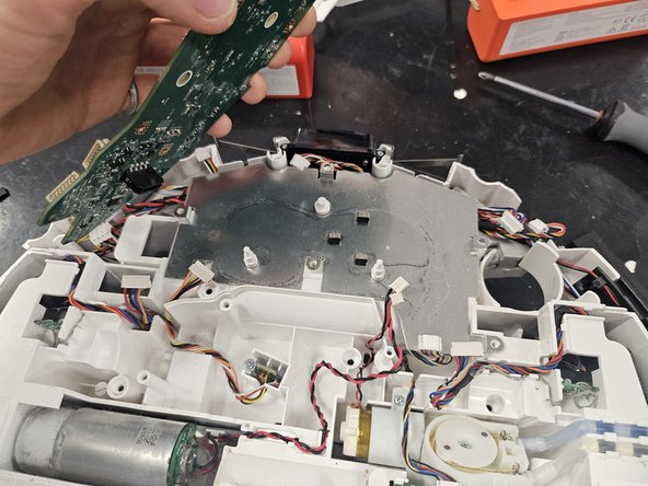

  14. Roborock S5 Max: Motherboard Replacement, Inserting a new motherboard.: crwdns2935265:014crwdnd2935265:01crwdnd2935265:03crwdne2935265:0 Roborock S5 Max: Motherboard Replacement, Inserting a new motherboard.: crwdns2935265:014crwdnd2935265:02crwdnd2935265:03crwdne2935265:0 Roborock S5 Max: Motherboard Replacement, Inserting a new motherboard.: crwdns2935265:014crwdnd2935265:03crwdnd2935265:03crwdne2935265:0
    • Put in the new motherboard, then use tweezers to free all the cables you've just squished under the motherboard.

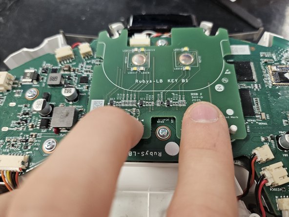

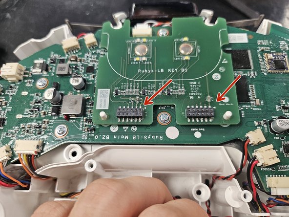

  16. Roborock S5 Max: Motherboard Replacement, Insert the button PCBA.: crwdns2935265:016crwdnd2935265:01crwdnd2935265:03crwdne2935265:0 Roborock S5 Max: Motherboard Replacement, Insert the button PCBA.: crwdns2935265:016crwdnd2935265:02crwdnd2935265:03crwdne2935265:0 Roborock S5 Max: Motherboard Replacement, Insert the button PCBA.: crwdns2935265:016crwdnd2935265:03crwdnd2935265:03crwdne2935265:0
    • Do not forget this!
    • Apply some pressure on the connectors. You will know you got them deep enough if you can see the motherboard's connectors just barely poking through on top.
