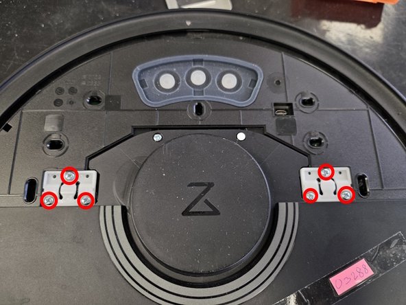

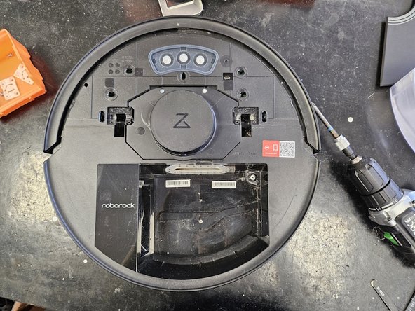

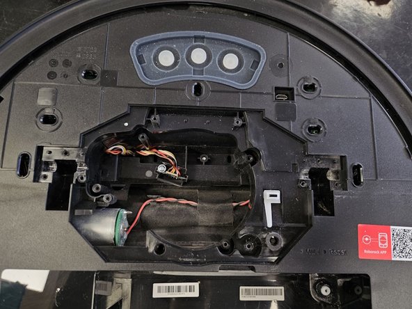

  1. Roborock Q7 Max: Teardown, Remove the top cover: crwdns2935265:01crwdnd2935265:01crwdnd2935265:03crwdne2935265:0 Roborock Q7 Max: Teardown, Remove the top cover: crwdns2935265:01crwdnd2935265:02crwdnd2935265:03crwdne2935265:0 Roborock Q7 Max: Teardown, Remove the top cover: crwdns2935265:01crwdnd2935265:03crwdnd2935265:03crwdne2935265:0
    • Begin by pulling off the front half.
    • Unscrew the screws, remove the plastic tabs.
    • Remove the back half.

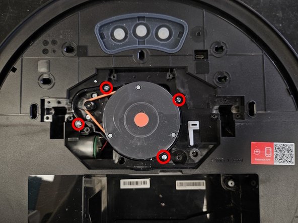

  2. Roborock Q7 Max: Teardown, LiDAR removal: crwdns2935265:02crwdnd2935265:01crwdnd2935265:03crwdne2935265:0 Roborock Q7 Max: Teardown, LiDAR removal: crwdns2935265:02crwdnd2935265:02crwdnd2935265:03crwdne2935265:0 Roborock Q7 Max: Teardown, LiDAR removal: crwdns2935265:02crwdnd2935265:03crwdnd2935265:03crwdne2935265:0
    • Remove the LiDAR cage.
    • 2 of the screws are covered by rubber tabs. I remove these by stabbing them with precision tweezers.
    • Remove the LiDAR.

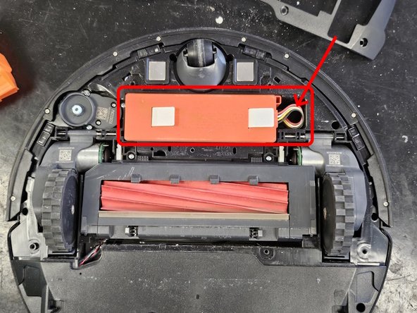

  3. Roborock Q7 Max: Teardown, Bottom cover and battery: crwdns2935265:03crwdnd2935265:01crwdnd2935265:02crwdne2935265:0 Roborock Q7 Max: Teardown, Bottom cover and battery: crwdns2935265:03crwdnd2935265:02crwdnd2935265:02crwdne2935265:0
    • Remove the bottom cover and side brush.
    • Remove the battery.

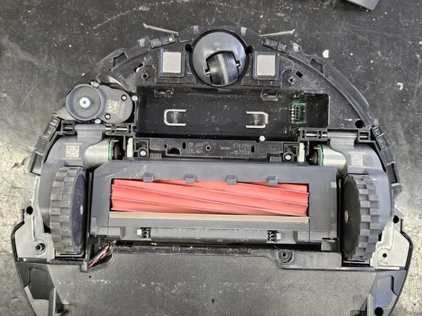

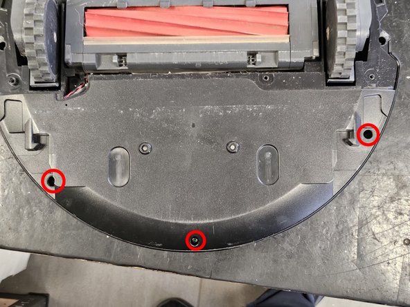

  4. Roborock Q7 Max: Teardown, Bumper: crwdns2935265:04crwdnd2935265:01crwdnd2935265:02crwdne2935265:0 Roborock Q7 Max: Teardown, Bumper: crwdns2935265:04crwdnd2935265:02crwdnd2935265:02crwdne2935265:0
    • Remove the bumper. These screws are all PH1.

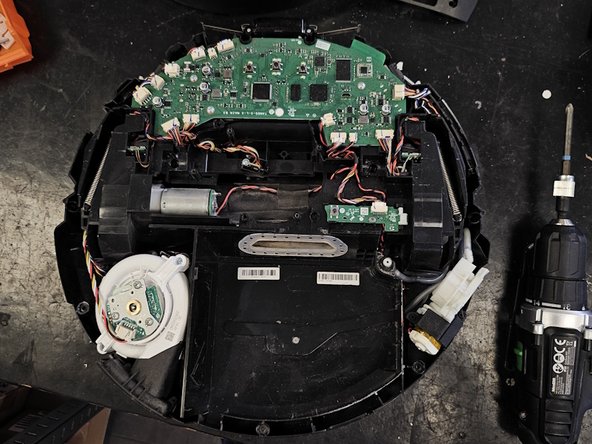

  8. Roborock Q7 Max: Teardown: crwdns2935265:08crwdnd2935265:01crwdnd2935265:02crwdne2935265:0 Roborock Q7 Max: Teardown: crwdns2935265:08crwdnd2935265:02crwdnd2935265:02crwdne2935265:0
    • Flip it over, then pull it apart.
    • It is still held together by 2 latches that are pointed to in the first image. Give it a firm tug.
