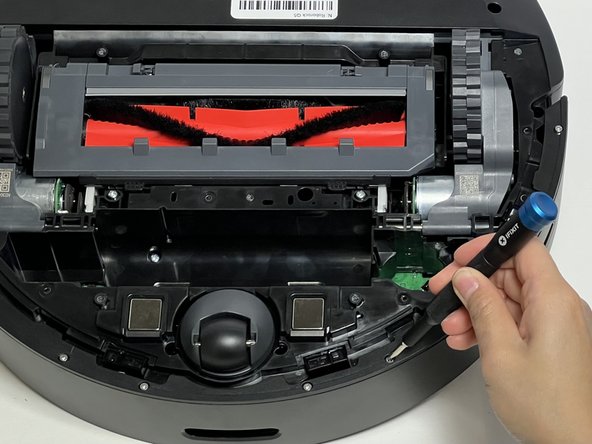

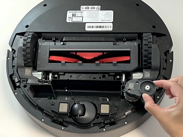

    • Power off your Roborock and place the device on a flat surface with the wheels facing up.
    • Position the robot so the five-pronged side brush is on the bottom right side.
  2. Roborock Q5 Suction Motor Replacement: crwdns2935265:02crwdnd2935265:01crwdnd2935265:02crwdne2935265:0 Roborock Q5 Suction Motor Replacement: crwdns2935265:02crwdnd2935265:02crwdnd2935265:02crwdne2935265:0
    • Use a Phillips #2 screwdriver to loosen the single captive side brush screw.
    • The screw is attached to the side brush so they cannot be separated.
  3. Roborock Q5 Suction Motor Replacement: crwdns2935265:03crwdnd2935265:01crwdnd2935265:02crwdne2935265:0 Roborock Q5 Suction Motor Replacement: crwdns2935265:03crwdnd2935265:02crwdnd2935265:02crwdne2935265:0
    • Lift the side brush up and off.

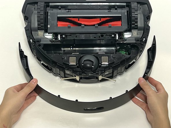

    • Gently lift off the bottom panel cover.
    • If the bottom panel is stuck, use a plastic spudger along the edges to gently lift it out of place, then remove it by hand.

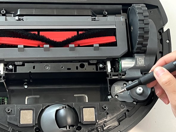

    • Remove the three 10 mm Phillips screws that secure the side brush motor.
    • Gently lift the side brush motor up and out of its housing.

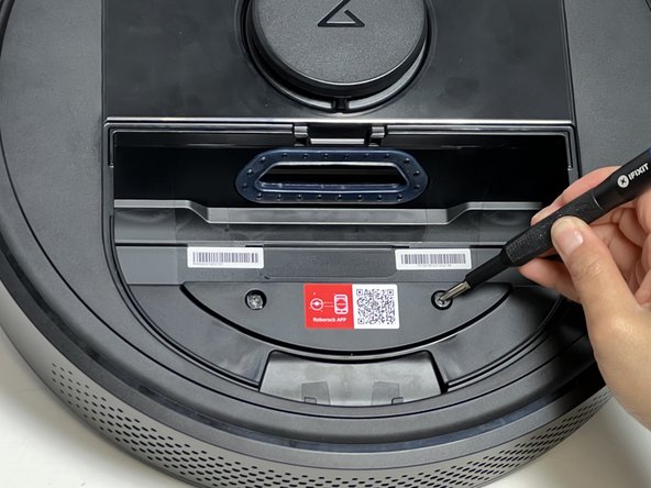

  13. Roborock Q5 Suction Motor Replacement: crwdns2935265:013crwdnd2935265:01crwdnd2935265:02crwdne2935265:0 Roborock Q5 Suction Motor Replacement: crwdns2935265:013crwdnd2935265:02crwdnd2935265:02crwdne2935265:0
    • Use a Phillips screwdriver to remove the two 15 mm Phillips screws that secure the front panel cover.

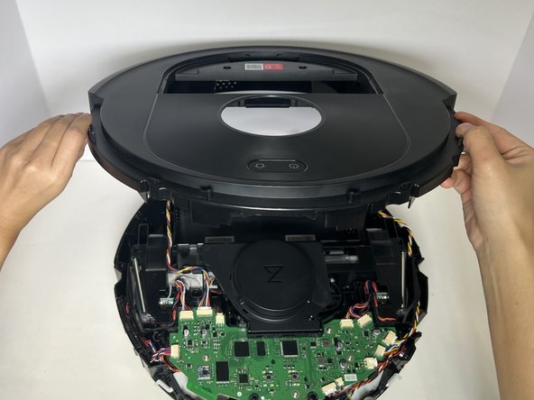

  14. Roborock Q5 Suction Motor Replacement: crwdns2935265:014crwdnd2935265:01crwdnd2935265:03crwdne2935265:0 Roborock Q5 Suction Motor Replacement: crwdns2935265:014crwdnd2935265:02crwdnd2935265:03crwdne2935265:0 Roborock Q5 Suction Motor Replacement: crwdns2935265:014crwdnd2935265:03crwdnd2935265:03crwdne2935265:0

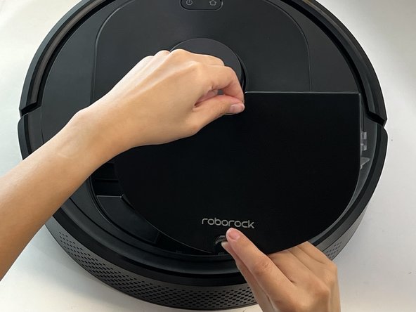

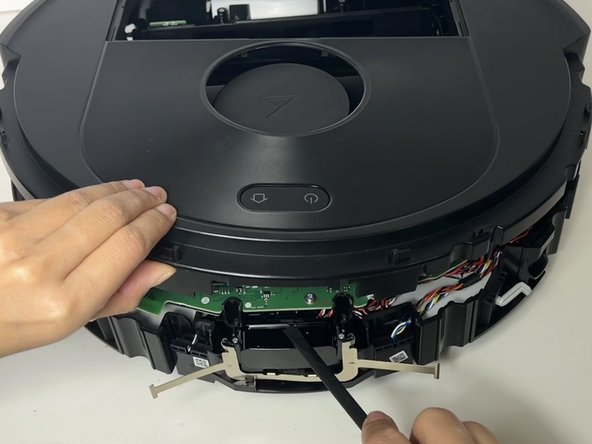

    • Use a spudger to pry up the top case.
    • Lift and remove the top case.

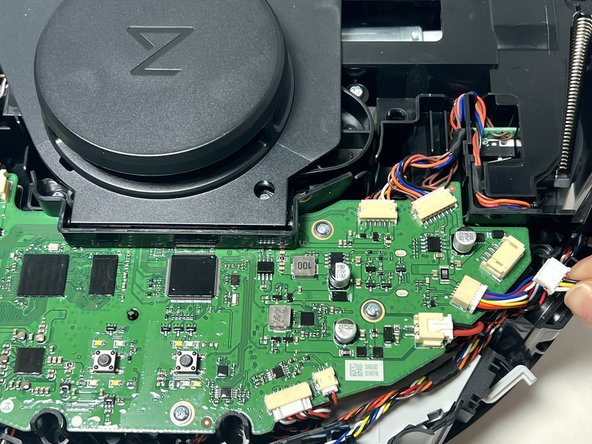

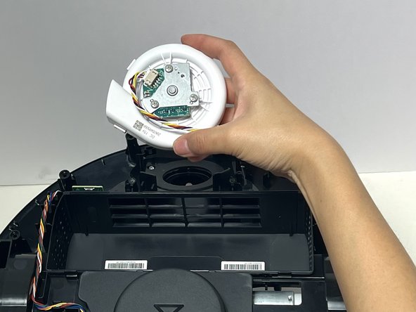

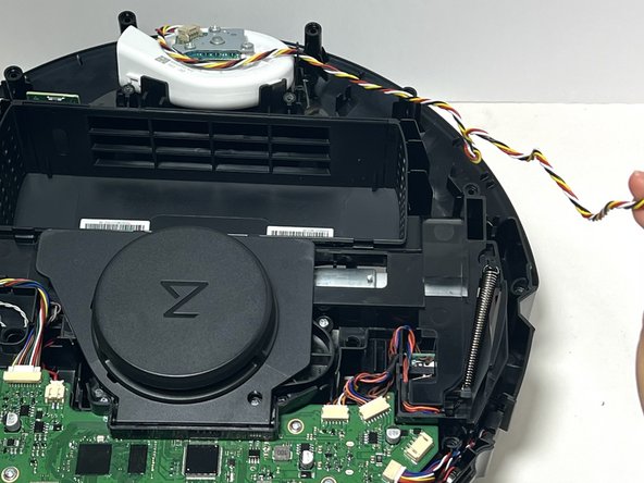

    • Lift the suction motor from its housing at the top of the robot.
  16. Roborock Q5 Suction Motor Replacement: crwdns2935265:016crwdnd2935265:01crwdnd2935265:03crwdne2935265:0 Roborock Q5 Suction Motor Replacement: crwdns2935265:016crwdnd2935265:02crwdnd2935265:03crwdne2935265:0 Roborock Q5 Suction Motor Replacement: crwdns2935265:016crwdnd2935265:03crwdnd2935265:03crwdne2935265:0
    • Grip the white suction motor connector and pull it directly out of its port.
    • Do not pull on the wires.
