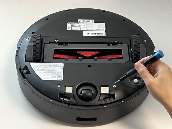

    • Power off your Roborock and place the device on a flat surface with the wheels facing up.
    • Position the robot so the five-pronged side brush is on the bottom right side.
  2. Roborock Q5 Side Brush Motor Replacement: crwdns2935265:02crwdnd2935265:01crwdnd2935265:02crwdne2935265:0 Roborock Q5 Side Brush Motor Replacement: crwdns2935265:02crwdnd2935265:02crwdnd2935265:02crwdne2935265:0
    • Use a Phillips #2 screwdriver to loosen the single captive side brush screw.
    • The screw is attached to the side brush so they cannot be separated.

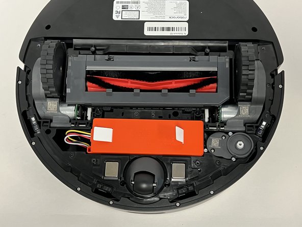

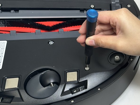

  4. Roborock Q5 Side Brush Motor Replacement, Side Brush Motor: crwdns2935265:04crwdnd2935265:01crwdnd2935265:03crwdne2935265:0 Roborock Q5 Side Brush Motor Replacement, Side Brush Motor: crwdns2935265:04crwdnd2935265:02crwdnd2935265:03crwdne2935265:0 Roborock Q5 Side Brush Motor Replacement, Side Brush Motor: crwdns2935265:04crwdnd2935265:03crwdnd2935265:03crwdne2935265:0
    • Use the Phillips #2 screwdriver to remove the seven 15mm screws from the bottom panel cover.

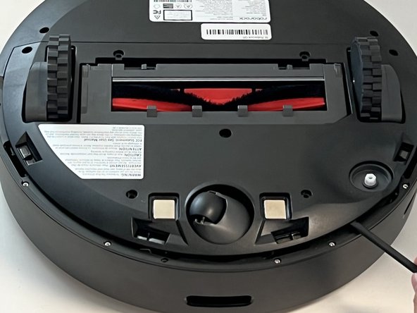

  5. Roborock Q5 Side Brush Motor Replacement: crwdns2935265:05crwdnd2935265:01crwdnd2935265:03crwdne2935265:0 Roborock Q5 Side Brush Motor Replacement: crwdns2935265:05crwdnd2935265:02crwdnd2935265:03crwdne2935265:0 Roborock Q5 Side Brush Motor Replacement: crwdns2935265:05crwdnd2935265:03crwdnd2935265:03crwdne2935265:0
    • Gently remove the bottom panel cover.
    • If the back panel is stuck, use a plastic spudger along the edges to gently lift it out of place, then remove it by hand.

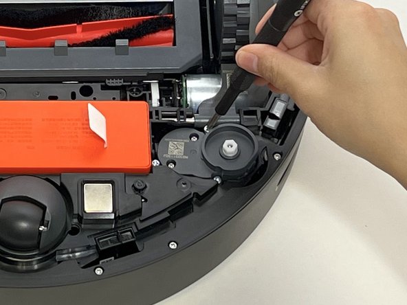

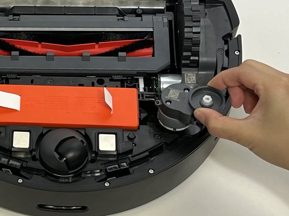

  6. Roborock Q5 Side Brush Motor Replacement: crwdns2935265:06crwdnd2935265:01crwdnd2935265:03crwdne2935265:0 Roborock Q5 Side Brush Motor Replacement: crwdns2935265:06crwdnd2935265:02crwdnd2935265:03crwdne2935265:0 Roborock Q5 Side Brush Motor Replacement: crwdns2935265:06crwdnd2935265:03crwdnd2935265:03crwdne2935265:0
    • Use a Phillips screwdriver to remove the three 10 mm Phillips screws that secure the side brush motor.
    • Carefully lift the side brush motor up and out of its housing.
